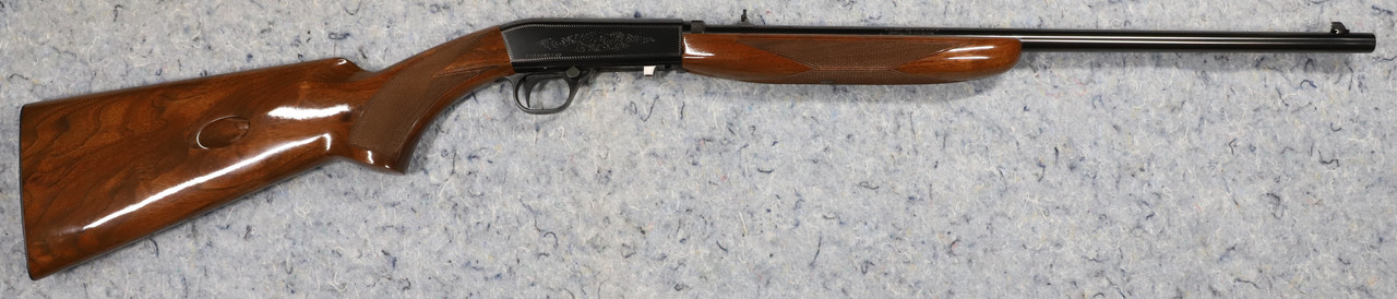

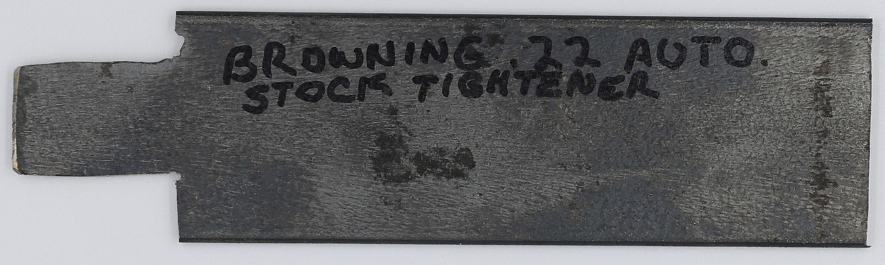

I was digging for gun parts and came across this tool I made sometime around 1996. I had just about forgotten I had it until this recent rediscovery.
[IMG][/IMG]
[IMG][/IMG]

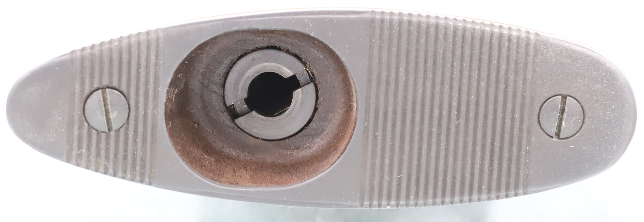

At some point, several years after purchasing my last Browning SA-22, I discovered that the stock had loosened from the receiver and the result was a gun that was just about impossible to shoot accurately - the barrel and action were free to twist in my hands. I made the tool pictured above out of 1/8" Strap steel and tightened the nut at the back of the stock, the one surrounding the magazine.
Here's a photo of the nut I'm referring to.
[IMG][/IMG]

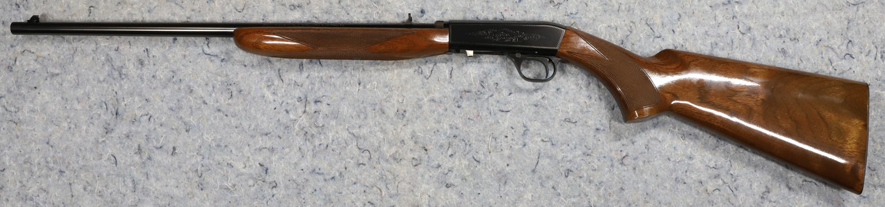

After repairing the rifle, I remember coming across a reference to this loose stock condition in one of the gun magazines of the time period. The author admonished his readers from attempting any repair on their own, and instead insisted that repair of this condition required return of the gun to a factory repair facility.
Mine has fired literally thousands of rounds in the 23 years or so since I tightened the stock. It has never jammed, and continues to be a very accurate .22.
[IMG]3[/IMG]
[IMG][/IMG]
Maybe I was just lucky?
Anyone else ever had this happen to your Browning SA-22? If so, what was your remedy?

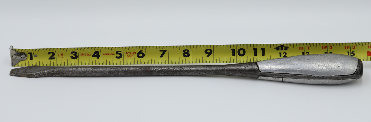

You have a standard blade screwdriver with a 3/4" wide blade tip that's 1/8" thick? That almost deserves its own post.

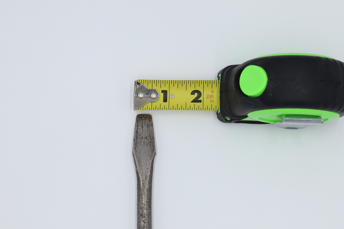

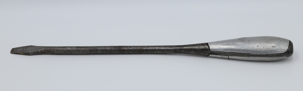

You've certainly got me beat! This is the largest screwdriver I own.
[IMG][/IMG]
[IMG][/IMG]
[IMG][/IMG]
As you can see, the screwdriver is over 15" long, shaft diameter is 0.441" and the 1/2" wide blade is 0.073", or approximately 1/16" thick.
You have got a monster there! I would love to see some photos!

If you start out with a piece of 1 1/2" X 1/8" strap steel as I did, keep in mind that the tip will need to be thinned a little to fit into the groove of the nut. In my case, the 0.130" thick strap had to be thinned to 0.103", or about 27 thousandths total to form a good fit.
Best of luck if you decide to proceed with the repair.
ETA: While it may be obvious to most; I should add that a Crescent Wrench will be necessary to provide the required leverage.
[IMG][/IMG]
[IMG]3[/IMG]
[IMG][/IMG]
A beautiful Browning like that well deserves you spending another half hour or so to take the tool you made and refine it a bit. If you really want to get into it - you could even make a wooden handle for it! The LAST thing you'd want to do it scratch or mar the screw or stock!
