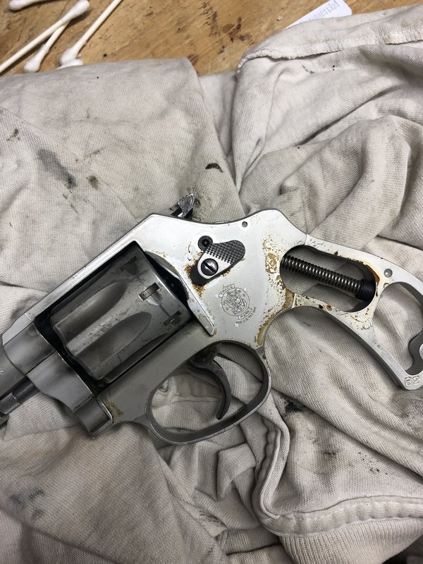

Okay, I was able to upload a few pictures, I took these last Sunday. My brother visited for a range trip. Heís new(ish) to handguns and one that he brought was a S&W Model 317-2, funny enough, same thing listed in a post above. This 317 is a two-owner gun. My brother in law got it new, my brother has it now. The only lube it has ever seen is RemOil.
When we were gathering the hardware for the trip, this little guy came out and the first thing I noticed is that the cylinder would barely turn. We all know how difficult that makes cocking the revolver and it makes double action shooting all but impossible ó and stresses components even attempting either.
The hammer block specifically was a magnet for this goo. The picture shows how nasty it is, unfortunately the later picture after it has been cleaned didnít catch the light well enough to show how different it looks after being scrubbed. It lost a portion of itís total weight in tar when I cleaned it!
While the tar on the outside but under the grip is obvious, the bigger concern was on the inside of the side plate. The goo seen here has a tacky, sticky feel. Press your index finger to the inside of the side plate and you can lift it off the bench, it clings to the fingertip.
I used a bit of non-chlorinated brake cleaner to loosen up muck but most of the cleaning was done with a Hoppeís#9, a rag and q-tips.
Functionally, sheís ďback to goodĒ and smooth. The cylinder will actually free-wheel and spin as it needs to.
The outer anodizing has taken a hit over time. Folks more familiar with alloy guns could explain better why itís eaten away. Iíd love to blame RemOil specifically but I canít be sure of that ó so I will stick to what I do know for sure, and that is, RemOil sucks.
RemOil turns to a sticky sludge and eventually to a hard lacquer much like the glaze on steel-case chi-com AK-47 ammo. I wouldnít let it near a pistol but itís far worse on revolvers where most folks donít ever go inside.
