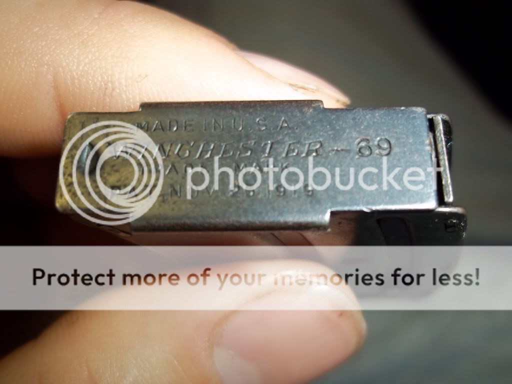

There were several types of magazines. The standard mag fed five long rifles, longs and shorts interchangeably. There was a five-shot .22 short mag also, which had an internal spacer insert at the front of the magazine. The single shot mag (actually a scooped-out flexible platform at the top of what appeared as a standard mag) was principally used for the Model 52 and Model 75 target rifles, but it would also work in the 69, the 69A and the Model 75 sporter. This was called the "single loading adapter." A 10-shot curved magazine which projected below the stock was also made, and took all lengths of cartridges. Magazines with an underlined "W" on the base are modern non-Winchester reproductions, but probably made on old Winchester equipment. Genuine Winchester mags will have the company stamp on the baseplate.

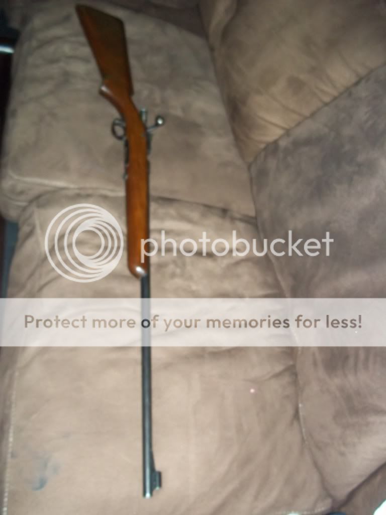

Hey everyone, Newbie to the forum but not to computing. I have some photo's of me recent purchase Winchester Model 69. perhaps you can give me some insight. I believe its a 1941 because the stamp on the receiver that i will post. Enjoy and thoughts please. [IMG][/IMG]
This is photo of original mag spoken of in this Thread starter
[IMG][/IMG]

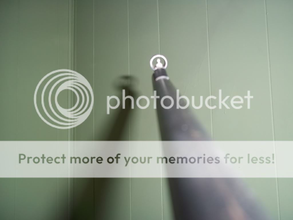

Front sight
[IMG][/IMG]

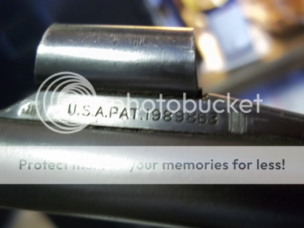

Front sight patent #
[IMG][/IMG]

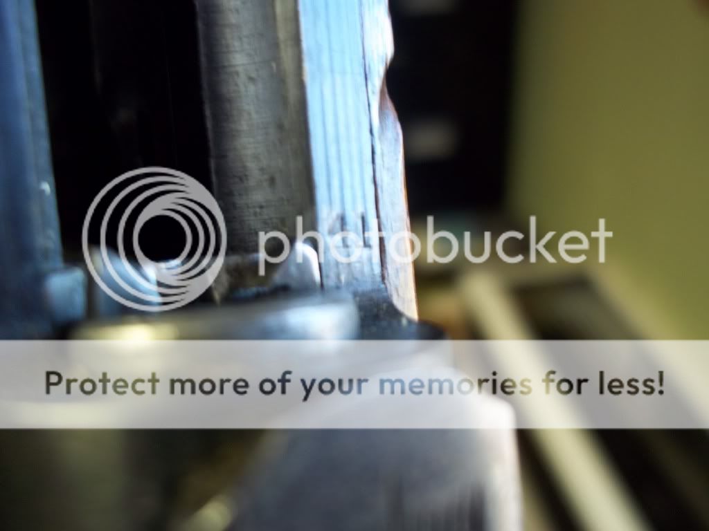

Date stamp on the receiver ????? Says "41" Have a look see yourself
[IMG][/IMG]

Hi, Randall, and welcome to the forum! It would appear that you have an original Model 69, not a 69A. These date from 1935 to late 1937, so you would be off a few years in your date estimate. The tip-off is the cocking knob and the cock-on-closing action. The stamp on the receiver is probably an assembly or inspection stamp. Since yours has the projecting takedown screw, the latest it could have been made would be about September of 1937.

Awesome, Do you have any insight on what the 41 means? Stoked its from 1935-37.
Sorry, John...I had to reread your post. You said, "an assembly or inspection stamp." Thank you sooo much.

You won't believe this, but I just got a 69A for a used toilet! kid you not. I didn't even really know what it was until I just got home and looked it upon line. I can't wait to strip it down and restore it. It is completely original, looks to be the match model.
This one is a Model 69A 22 Short, Long and Long Rifle, has the Lyman peep. Interestingly, the magazine has a patent of Nov. 25, 1919
Anyone know the age of this one? I love the feel of this gun, an american classic and goes well with my Winchester '94.

I just purchased a Winchester 69 from a buddy for $100. It has both the .22 short and .22lr. magazines. It is a first generation model with the "safe" & "fire" bolt. I read that they were made from March 1935 until Sept. 1937.
In August 1935, the bolt was redesigned to incorporate a "rebounding firing pin". I have no idea what a rebounding firing pin is. How would I know if my rifle has the original style bolt or the "rebounding firing pin"?
Any and all assistance will be greatly appreciated.
