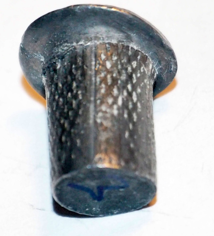

Thanks everyone for your input, really appreciated. I checked a bullet I retrieved some time ago, rifling engraving seems not to be existing consitently. I tried some photographs, sorry for the quality.

in post #6,
the marks on the bullet looks very light, which makes me believe that this brand might be just a little undersized for your barrel?

I agree with Nevada Ed, the lack of engraving says undersized bullet, especially since you get the same results in different revolvers of the same caliber.

Daimler1989,
You mentioned that the recovered projectile you have photographed is an old one. Is it from the same batch of projectiles that is giving you trouble? Did that load also keyhole?
If not, looking at one of the current, keyholeing projectiles would be a good idea.
And you need to measure the diameter of those projectiles.

Hi,
thanks everyone again for new input. I slugged the barrels and chamber throads of all my .357 Magnum revolvers, but the batteries of my caliper are empty and need to be replaced. So no exact data at the moment.
BUT: I went the easy way an tried to pass several bullets through the chambers. Interesting. Speer LSWCHP and a hardcast SWC I regularly use don't pass through. Both advertised as.358 diameter. The Hornady LSWC HP FALLS through. Altough it should have .358 diameter as well...
I have no possibility to use a new Hornady as they are all loaded. I used a bullet I pulled off by inertia bullet puller. So far, I suspect the Lee Factory Crimp Die I used to use to be the scapegoat - recalibrating the bullet to less than .357 diameter. I will go and try the other bullets with a dummy cartridge and the factory crimp die, then pass through the chambers again. See what will happen.
regards
Ulrich
