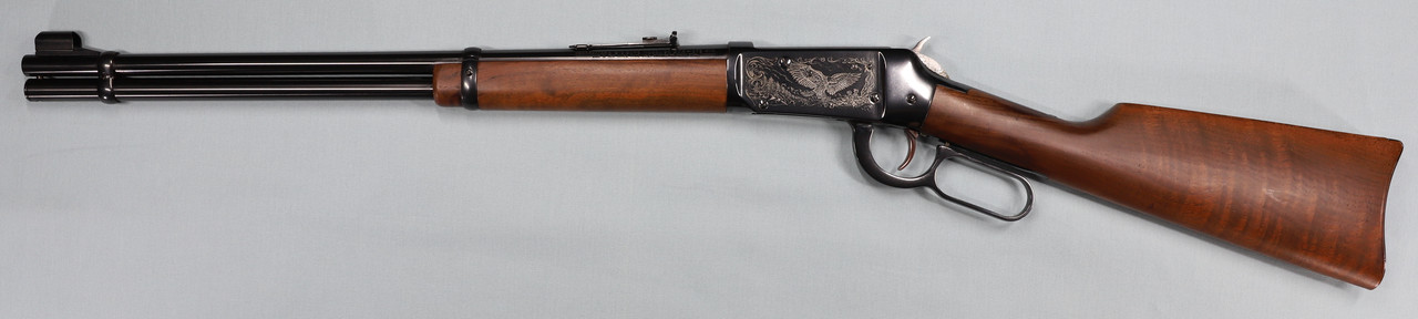

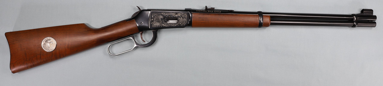

I purchased an unfired Big Bore 94 in 375 Winchester at a local gun show back on the 29th of August of this year.
[IMG][/IMG]
[IMG][/IMG]

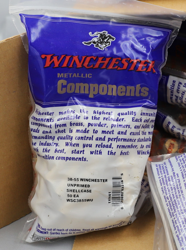

In the middle of my search, I came across a plastic bag containing 60 each factory new Federal 30-30's for $10.00 at my local gun store. That seemed to be a good price and I bought them and subsequently loaded all 60 with a case blow-out load so they can be converted to fire in my new 375 Winchester. Here's a photo of twenty of those 30-30's loaded and ready to be fire-formed.

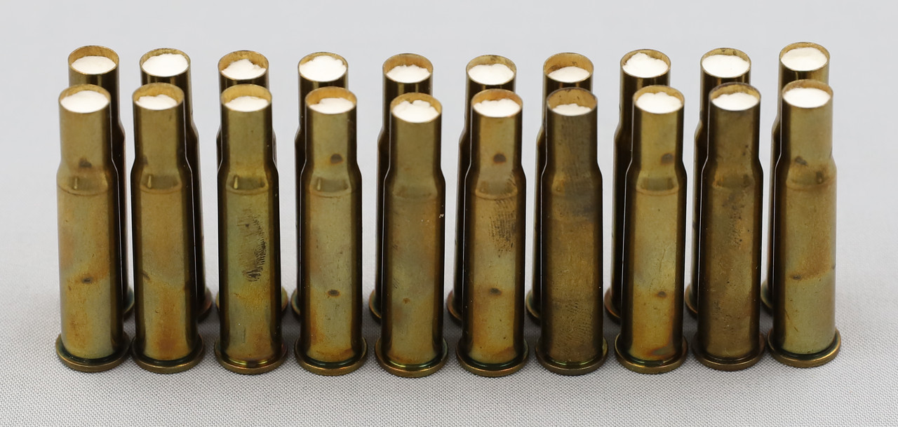

Then, the other day, I went into my stored reloading brass looking for some 41 magnum cases. I happened to notice a cardboard box that had never been opened, and decided to investigate... What a shock it was to discover the box contained 500 each (10 bags of 50 each) factory new 38-55 cases. I opened one of the bags to get some measurements, and sure enough, these are the short ones; 2.082" in length. I took one of these 38-55 cases and ran it into the chamber of my 375 Winchester, and it slid into the chamber easily and the bolt closed over it with no signs of brass impingement at the case mouth.
Here's the brass:
[IMG][/IMG]
[IMG][/IMG]
[IMG][/IMG]
I had apparently ordered this from Midway USA some time around 2006-7 to use in my Model 94 short rifle chambered for the 38-55. I sold that rifle to a friend with more money than sense, and during the ensuing 15 years or so, I had managed to completely forget about the box of new 38-55 cases.
My intent is to load some of these for my 375 Winchester, and the only real decision is; do I trim the repurposed brass to 375 Winchester length, or do I leave it the original length so it can be used in a 38-55 chambered gun in the future?
Thoughts and opinions, especially from those with first hand knowledge/experience shooting either blown out 30-30 brass, or 38-55 brass in their Big Bore 375's would be much appreciated.

Don't load to375 vels or pressure. The brass is not able to handle it. Just a word of caution. I may have some 375 brass but once fired...also 356 Win. I may know a fellow with brass also. Will call him in the morning

Itís my understanding that you can shoot .38-55 Win in a .375 Win rifle.
Starline is now selling .375 Win brass. It seems they have it in stock.
Buffalobore also sells a heavy .375 Win load thatís better than the original factory load. Good time to have a Big Bore!

375Win is shorter than 38/55. 38/55 can be trimmed to specs. 375 win is heavier brass than 38/55. In past 30/30 and 38/55 would have been drawn from same button. Case heads would be same. So blowing out 30/30 is fine for 38/55 level loads in 375Win. I wouldn’t load full house loads in this brass. As for Starline, I don’t have any but wonder if it’s just short run of 38/55 cases. In other words same as 30/30 brass.

Yes the brass is stronger but in a pinch I would exceed 38-55 loads in that rifle only with 38-55 brass. You are running the risk that someone else can fire it in your gun. If I did so I would mark each case. Obviously 375 Win is the best brass. With the strength of the BB rifles the brass thickness is not an issue, though internal case capacity may be slightly larger.

Save the 30-30 and "55" cases for light 100 yard practice loads and your plinking or jack rabbit loads, or what ever is your light duty shooting stuff.
Save the 375 cases for full loads and for hunting deer or Hogs, if you do that sort of thing.
I look at the 375 as a "Magnum" 30-30.
A great load if you don't try pushing it past 200 yards.
A vote for 4198 or RL-7
