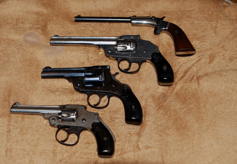

I have just inherited an S&W "Lemon Squeezer" in .32, New Departure First Model (I believe)with a very low serial number ('24xx').
Is there a table showing serial numbers vs. year of manufacture for these S&W handguns? I see that the first posting in this thread says that s/n '45xxx' was made around 1890, but I thought the first year of manufacture was 1888?
It's in moderately good condition, and appears to be fully functional. My Grandfather probably carried it around in the 20s and 30s (not a pampered collection gun). I have no plans to restore or to shoot this gun, but would like to know all I can find out about it.
I also inherited some other handguns from the early 20th century:
1. J. Stevens Arms & Tools break-top single-shot .25 caliber centerfire "parlor pistol" or "gallery" (?) handgun in excellent condition. No trigger guard!
2. Iver Johnson Arms & Cycle Works break-top 5-shot .38 S&W. Last marked patent is 1897.
3. Harrington & Richardson Arms "Automatic Ejector" model break-top 6-shot .32 S&W (long).
Here are these four (S&W at the bottom):

Welcome to the collecting world and the board Moose. The only way to know the shipping date for sure is to pay the 30 dollars for a factory letter. But, I have first model 32 Safetys with serial numbers 10xx and 23xx and they both shipped in May of 1888. It is a good bet that yours shipped in mid 1888 also.

Hi Ohio, You are correct in that the model in question was introduced in 1888 and was produce until 1900 when changes were made resulting in what is now called the Second Model. Anyway, I have a factory letter (30 bucks; search forum for S&W History Request Form) on #283xx which shows shipment on Jan 1, 1892. Ergo, obviously produced in 1891. The letter only provides a ship date. Yours should be earlier than mine, naturally. Hope this provides a little bit of info for you. Regards, Ray
