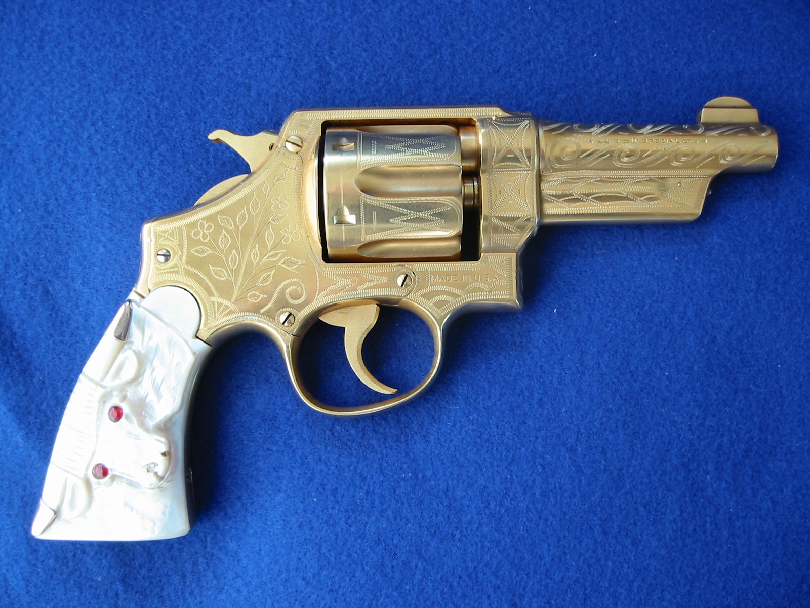

I've looked at this engraving style for a while and think it might be Wolf & Klar. Look at the pic below and see the similarity.
Alternatively, it could be someone in the 1930's taking off their style.
What you think.
What you think.
This gun you posted is a classic example of "Pawn shop" style engraving, in that all the marking done to the gun was done by scratching or punching marks into the guns finish. If you look at the original gun in this post, look at the flowers and some of the other marking, they are done with engraving tools where you actually remove slvers of the steel by cutting either with a air powered tool or with a hand tool and hammer. I persoannly use a Gravermax made by GRS, if you guys want to see it in action I can do some practice cuts maybe in a short video so you can see the way it removes the metal? Its a completely different process than the Paw shop punch style engraving though they can both be done on the same gun, like this Reg Mag has been done.

Gun #1 (RegMag) and gun #2 are both wriggle (riggle) cut. #1 has a few single point cuts in addition that #2 doesn't have.
Wriggle cut engraving is done quickly with a graver, not a punch. Punch marks are usually added to this type of pattern though to enhance it.
A flat graver is the usual tool, different widths, liners will add a different effect.
Fox shotguns use liners in wriggle cuts occasionally in their patterns in the graded guns.
Round point gravers are sometimes used to wriggle cut a gold/silver line inlay.
The wriggle cut does remove steel(inlay material) and if everything is going correctly a nice ribbon of steel will curl up in front of your graver as you walk it quickly accross the piece on a fine cut,,a series of chips on a coarser pattern.
Same cut that Parker used on the VH grade borders and Browning/FN used on the borders of the A5 rec'vrs

Dave B
On the bronze beauty, it looks like the side plate has been replaced.
Does the other side of the gun have a logo ?
I'm just wondering if the gun originally had the logo on the side plate,
and the engraver did not want a logo in the pattern, so replaced the
side plate ?

I have never heard anything called riggle or wriggle engraving. On the gold gun almost all that work is pressure work and NO material is removed. The engraved Reg Mag have actual engraving, lots of it, look at every flower.The center of every flower has many cuts with large slivers of material removed, COMPLTETLY different than the punch work of the gold gun.

Found a cool glossery of terms for engraving that does show wriggle cut, examples below. The first gun is still a combonation of both with alot of basic engraving that the second gun does not have....Like all the large flowers on the first gun, no wriggle did that...
WIGGLE TOOL or WRIGGLE TOOL – 1. A burin shaped like a flat chisel, used to engrave zigzag lines. 2. The engraving created by a wiggle tool.

There's no punch work on the gold gun. It's done with the same technique as the RegMag,,wriggle cutting,,or how ever you want to spell it. It's been around for as long as engraving on metal has been around. Looks like a few single point cuts in the stems of the 'flowers' too.
The RM does have the more traditional single point engraving work in the flowers & shading plus the cross hatch work in the background around them. A few well placed hollow point punch parks here and there.
Wriggle,, riggle,, wiggle,, cutting does indeed remove metal. It is not a scratch technique nor a laborious criss-cross punch technique. It is quick to learn, easy to control and can cover alot of area in a hurry.
The gold gun engraving was probably done in little more than an hour if applied by someone skilled in the technique. The RM somewhat more but certainly less than a full day at the bench if he/she knew what they were doing.
Here's a few rather quick pics I took,,unsized 'cause photoshop didn't want to work for some reason...
A few different sized flat gravers being used for wriggle cuts & one liner for the same. You can see the steel cuttings in front of the graver in one pic.
Not the best pic but cutting and taking a pic at the same time wasn't easy!
Steel being cut is actually the shank of a home-made letter-stamp so it's quite tough steel.
In this type of cut the flat graver is 'walked' across the surface to cut the criss-cross pattern. Altering the pressure, speed and angle will get different results.
(Pics off color from the florescent lighting)
I then added a freehand 'flower' similar to the type on the RM with shade cuts, all single point cuts as on the RM and a few hollowpoint punch marks. Cut time for the flower.. 2 minutes. Some of this stuff can be done very quickly.
The top jaws of the engaving vise look kind of worn close up after nearly 40 years.

Mike - you were correct, the logo is on the left side of the frame. See the pic below.
Pontiaker - You have some interesting opinions but, unfortunately, you'd lose your bet.
Dan - the gold wash gun is another Wolf & Klar example, they came in various "levels" of engraving as you probably know. Jerry Campbell acquired this gun in 1930 at the same time as Delf (Jelly) Bryce purchased his famous .44 Special. They were both detectives with OK City PD at the time, before both joined the FBI in 1934.
I find these Wolf & Klar guns fascinating, like everything else from the 1930's
Regards.

The gold wash gun has NO normal style engraving cuts, all Pawn Shop style period. The Reg mag has many of the more normal and common style engraving, like on every flower on the gun and more coverage, period.
