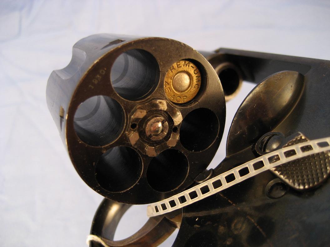

Kevin you are correct, only at the beginning of the Colt M1917 contract did Colt use cylinders requiring the use of moonclips. Eventually they started using cylinders with headspacing shoulders in the chambers so they could be fired with or without moonclips such as S&W had done with their M1917 production from the very beginning.
I have an all-original early Colt M1917 example still having the cylinder that requires moonclip use. All of my later serial numbered Colt M1917 examples, as well as my Colt Civilian Model of 1917 examples, have the headspacing shoulders in the chambers.
Just to clarify, the early Colt cylinders that require moonclips were not technically bored straight through. There is a shoulder in the chambers as one would expect on any normal rimmed revolver cartridge chamber. Unfortunately this early shoulder style allows the .45acp round to fall too far into the chamber as to prevent reliable primer ignition. On my early Colt M1917 example it will allow .45acp cartridges to go in about flush with the rear cylinder face instead of sticking out enough to properly headspace.
From what I have read many early Colt M1917 cylinders not having the correct headspacing shoulders in them were swapped out with later style cylinders that did allow one to fire the revolver both with and without moonclips.
Occasionally an early style Colt M1917 still having it's original style cylinder pops up on the radar.

Kevin,
I have seen a few but not very many. One thing you have to look out for is that many later style Colt cylinders may have had their original chambers reamed/modified to accept .45Colt ammo.....thus the owners think they may be the early style cylinders. An all-original unmolested early (or later) Colt M1917 cylinder will not properly accept .45Colt ammo.
Here's a pic of my all-original early style Colt cylinder that will not fully accept .45Colt ammo. (It's the same revolver/cylinder as in my previous pic showing the unclipped .45acp ammo going in flush with the rear cylinder face.) This is another reason I try to correct folks when they say early Colt cylinders were originally bored straight through as this is an incorrect statement. If they were simply bored straight through then .45Colt ammo would go all the way into the chambers.
Dale

Originally Posted by tenntex32 View Post
Kevin,
Dale
Excellent observation. Perhaps the shoulder machined too deep was actually just a manufacturing error!
Jim
S&WCA #819
Reply With Quote

For comparison sake , here's my Mod 1950 in .45 Colt. (Letters)
Note the headspacing- also the cylinder is longer.
SWCA #3356, SWHF#611
