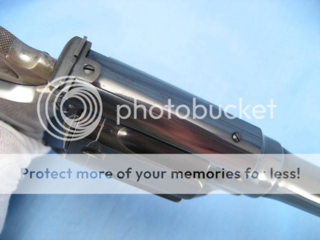

Cool Is this a K-22 OD 2nd Model aka K-22/40
Advertised as a "K-22 2nd variation". The serial number 672xxx falls quite a bit earlier than the known range for K-22/40's and, if I understand the differences correctly, the rear sight looks like a 1st model.
Am I correct?

You are correct. The Second Model had a click adjustable rear sight.

Default OD vs. K-22/40
First Model, Second Issue.
Here's the best way to visually tell the difference between the Outdoorman and the Masterpiece, Prewar, AKA: K-22/40 without cocking the action.... the OD is a long action gun and K-22/40 Masterpiece is a short action.
Note the sights..
K-22/40 is on top...
Drew

Drew - thanks very much for taking the time to upload the pictures. I was pretty sure I had a good visual on the differences and your pictures confirmed it. Obviously the short action feature requires the gun to be "in hand". I pretty certain that my eyes would not be able to discern a long vs. short action from a picture of a cocked hammer!
