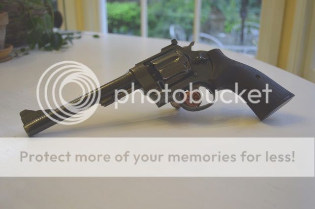

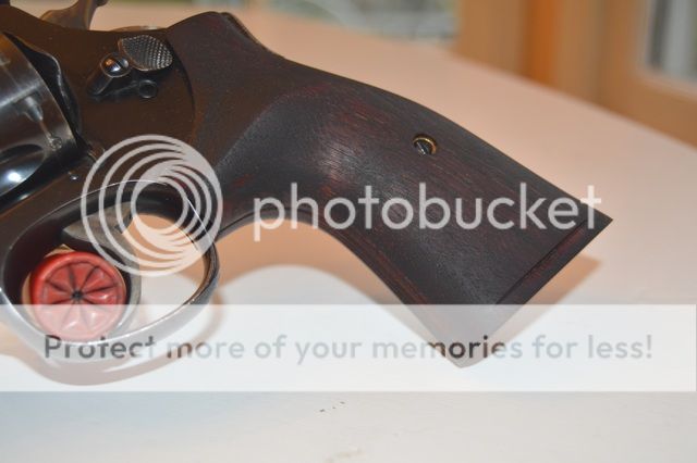

I had an old pair of Herrett k-frame grips that I modified to fit the.455 HE. They don't fit exactly but they're good enough to shoot with. Now all I have to do is get to a distant range. Mine closed a year ago.

A couple of images of the gun with grips
[IMG][/IMG]
[IMG][/IMG]
