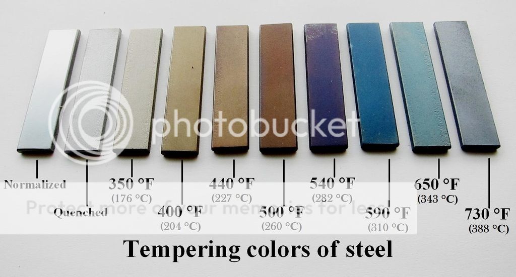

BTW, Bigwheelzip's revolver (Swiss, I think) has yellow tinted ("Straw" colored) parts which are a function of the final tempering process temperature. The color has more to do with the desired hardness than aesthetics. But it does look good.
Cool, I wondered what did it. Thanks.
I took your info and found a graphic for it.
While those temps MAY cause those colors to appear it is far from hard and fast. The color that can appear in a piece of polished steel when heating depends on the alloy, the atmosphere and any possible contaminates in it (oil, carbon etc) as much as the temperature. Plus the color is extremely thin. I have colors show up all the time tempering knife blades. If I take 1095 and don't do anything about the atmosphere it will USUALLY turn straw at 400f if I put it in a air tight foil packet with a bit of paper the paper will smolder, use up the oxygen and it will probably be blueish. Coloring steel is an art more than a science.
In IMHO Johan Gustafsson is the king. Look at an example of his work.
BladeGallery: Fine handmade custom knives, art knives, swords, daggers
On MIM and spinster metal remember once the binder is gone it is ac completely different animal. Thompson Center has been making spinster frames forever. How many or those fail even firing some crazy rounds for handguns?

Originally Posted by steelslaver View Post
While those temps MAY cause those colors to appear it is far from hard and fast. The color that can appear in a piece of polished steel when heating depends on the alloy, the atmosphere and any possible contaminates in it (oil, carbon etc) as much as the temperature. Plus the color is extremely thin. I have colors show up all the time tempering knife blades. If I take 1095 and don't do anything about the atmosphere it will USUALLY turn straw at 400f if I put it in a air tight foil packet with a bit of paper the paper will smolder, use up the oxygen and it will probably be blueish. Coloring steel is an art more than a science....
Much more true now, but in the 1800s through the early 20th century, temper colors were an easy and pretty repeatable method of controlling final heat treat in a production environment. Especially under the watchful eyes of experienced workers and inspectors for military items such as the Swiss revolver above.
As for TiN coating of action parts, it's just another take on case hardening, hard chrome, etc. QPQ nitriding noted above may be an option if the final polish doesn't round off edges of the tiny sear surfaces.

Those colors and temperatures and colors do run pretty true for tempering steel like 1095 and W2 the most common older plain high carbon tool steels in a regular atmosphere.
For hardening the color is a red shade that can be detected in low light by the well trained. Another interesting fact about heat treating is that all steels become austenitic at about 1425 f and a magnet will no longer tick to them. This is just bellow the proper temperature for simple carbon steels to be quenched from. In the days before pyrometers and well controlled ovens these methods were often used.
Now days a electronic device known as a PID will allow you to control an electric oven to within 1 degree, even gas heated ovens can be controlled with them using a solenoid valve to control the gas flow. This allows for much more controlled and precise HT. Plus a lot of precision HT is now done in an controlled atmosphere with no oxygen to react with the carbon. If O2 is present at higher temps there will be a thin soft layer on the part, lacking carbon, after quench that needs to be removed to get to the harden steel. Kind of the opposite of color case hardening where the part is buried in a carbon rich material, heated andd allowed to soak and become carbon rich.
Many modern stainless steels need temps above 1800 and some as high as 2050f to properly harden. plus tempering into the 800f range. Most of the parts on a revolver even a non stainless one are relatively soft and I suspect tempered to somewhere near 800f. For hard wear surfaces like sears around 400f would give an Rockwell C of around 60 with 1095. 450 f (RC 58) less apt to chip an edge for maybe the bolt and hand? With something like 4140 or 4150 the RC numbers would be lower because of the lower carbon content. I would love to see S&W heat treat and steel specs.
