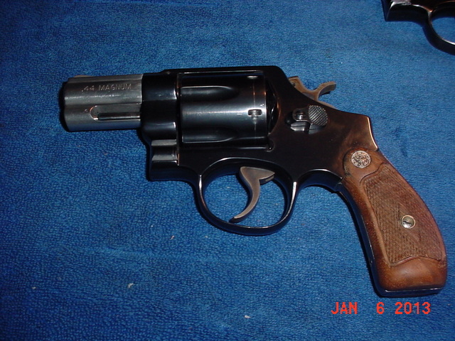

Several years ago I turned a re-blued 58 into a .44 mag. I was lucky enough that he serial number was stamped towards the front of the frame and could make it a round butt also. I thought it made for a nice feature on a fixed sight gun.
Good luck with your project!
Mike
P.S. I did all my own work so I don't have any suggestions for a gunsmith.
