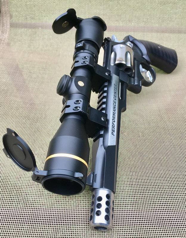

As colt_saa's list shows, all Sc/Al alloy frame models have (2) or (3) piece barrels, AFAIK.
If we're expanding the list to include (3) piece barrel revolvers you can add the PC 325TR & the PC 460XVR snubby to it.

I think the 629 PC Hunter also has a 3 piece. The one with the Comp. ..
Correct Lou. I think you're talking about the 629-7 Magnum Hunters. The comp is also a 'nut'.
I remembered when you told me about them. If the comp is the locking nut, that makes em 3-piece barrels. Too.
I had that mixed up in my memory as a 329 Hunter.
I should have remembered, I like that two tone finish it has
