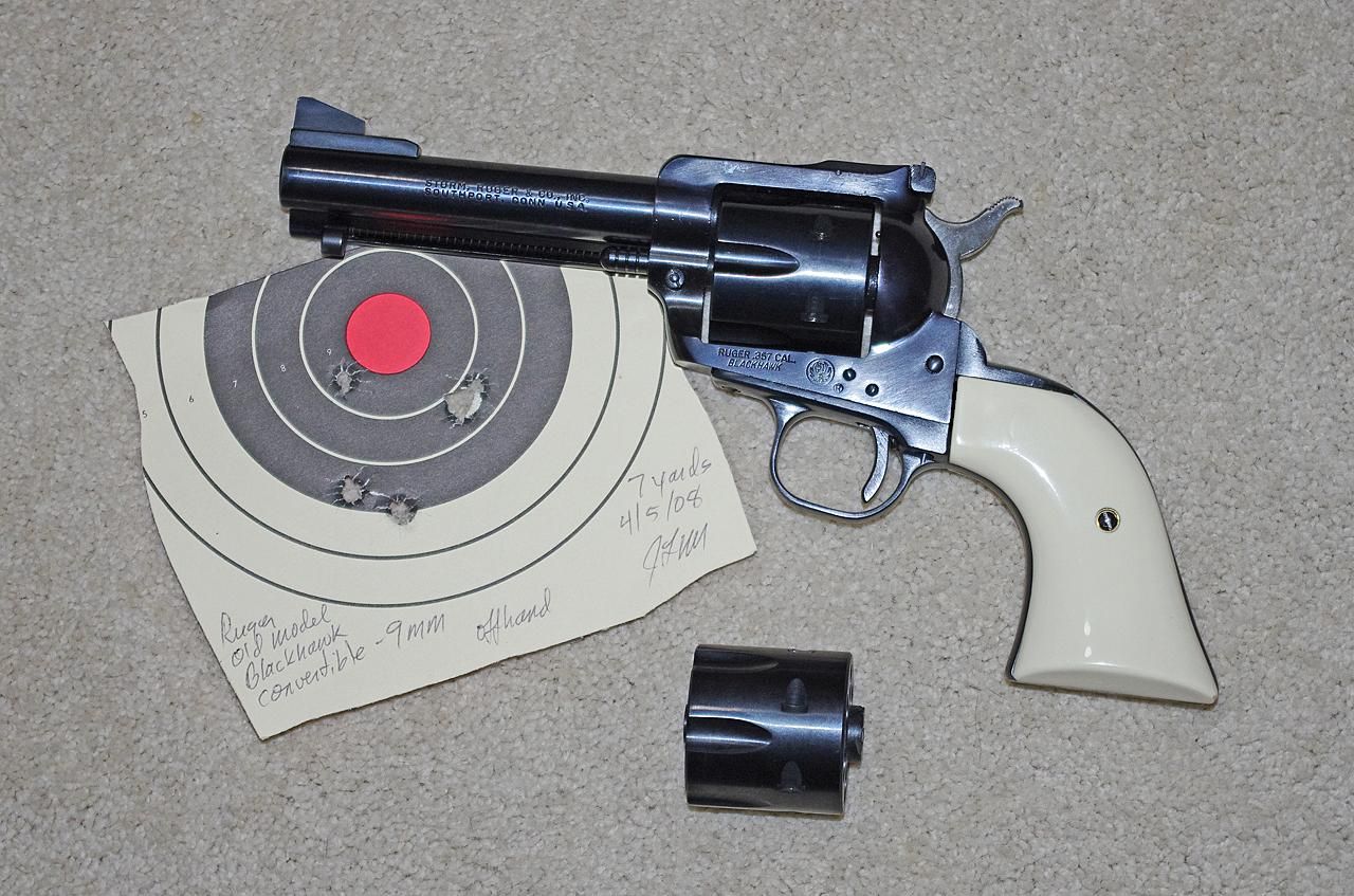

It works best with Single Action Revolvers like the Ruger Blackhawks .
A .357 Magnum Blackhawk can have at least 6 different chambered cylinders from 380 auto to 357-44 Bains & Davis !
Just my thoughts ... I thought the 45acp / 45 Colt was a great combo!

The problem isn't complex if you have dual cylinder traditional single action revolvers - pull out the cylinder pin, put in the other cylinder and replace the pin. This can be done in seconds!
