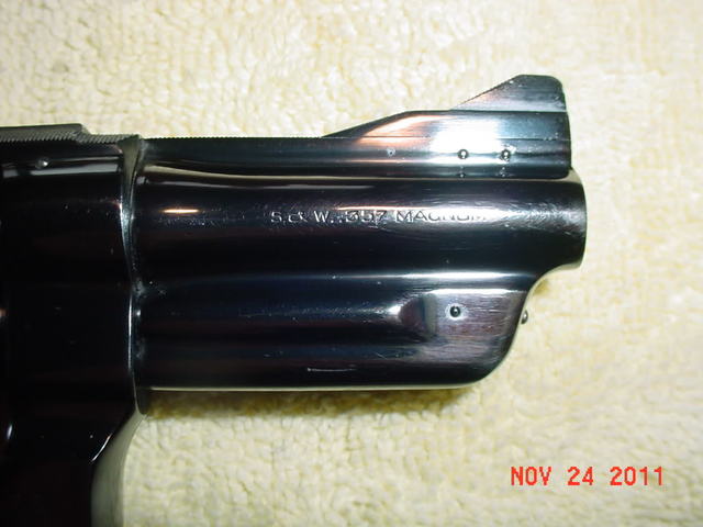

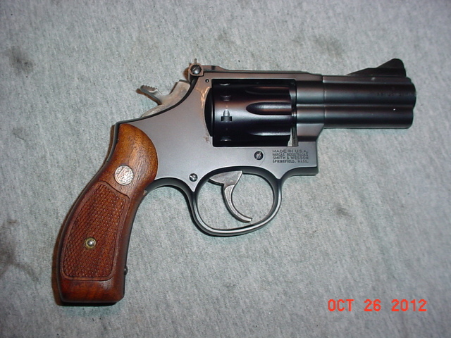

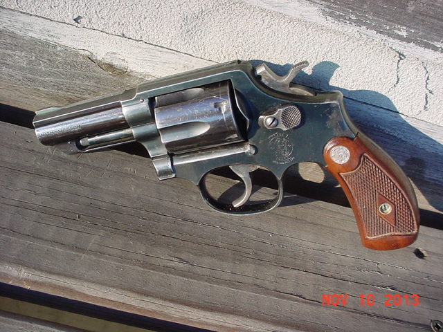

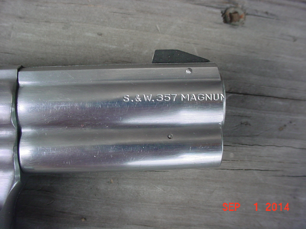

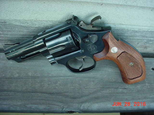

A 4 inch model 19-7 with factory round butt, whacked off to 3 inches.
An unfired model 617-1 with a 6 inch barrel, whacked off to 3 inches before it was ever fired.
A 6 inch model 17-8, 10 shot k22, whacked off to 3 inches.
A model 13-3 with a model 19 barrel whacked off to 3 inches
A model 681, 4 inch L frame, whacked off to 3 inches with night sight.
One of my favorite past times is whackin' off K frames
Ned

All of the sights are pinned on. Here is the 617-1. I used only 1 pin here.
I cut the sight off the 6 in. barrel, flipped it upside down in the end mill & machined a tenon on the bottom of the base, ala S&W. Then use a slot or keyway cutter to machine a slot for the tenon in the top of the barrel rib.
This 19-7 has 2 pins holding a factory S&W sight on, the way S&W did it in the 50's & 60's. The pins were left "proud" so you can see "em. Not to be mistaken for a factory gun.
The 681 has a pinned night sight available from Brownells for multiple applications.
Ebay is a good source for donor barrels, as well as original S&W sights from time to time. Also Numrich comes up with some NOS old stuff every now & then.
This factory pre-27 barrel has an example of "proud" pins.
This barrel has an example of not proud pins. You can barely see them as they have been blended in.
Hope this helps.
