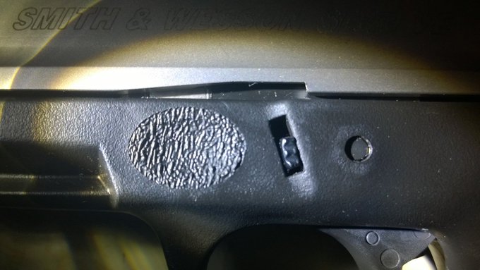

Unfortunately, I found this thread after I already purchased the 21# galloway guide rod for my sd40 ve. Of course the photos and first hand accounts of the steel rods breaking off the frame tabs was worrisome but then also read that Galloway had slightly tweeked the design/spring to fix the problem. Still felt uneasy.....
so I sent an email to galloway to check on 2 things.
1. was the rod I purchased from amazon(to get free ship) guaranteed to be one of the "fixed" design rods directly from GP.
Yes they assured me only the new rods were shipping directly from them, even on amazon orders.
2. Was the problem taken seriously and specifically addressed so that SD40 owners can safely use the product without risking damage to the tabs. Here was the response on that...
"The problem wasn't with the guide rod, it was an anomaly in the pistol itself. We addressed the issue with the pistols themselves and changed the design of the guide rod to
accommodate any other tolerance anomalies in the pistol frame in the future."
I don't like parts of that answer to be honest. IMO the original problem WAS with the GP guide rod/spring assembly. If it wasnt, then even sd40ve's with stock guide rods would be experiencing damage/breakage of the frame tabs that are chipping or breaking off. However, he did mention the change in design to the guide rod which i see in [@]TS7424 's photo for sd9 guide rods.
When i get home I'm going to find a comparison pic for the sd40 rods to see if my supposedly new design rod is visibly different and then Ill try the test racking the slide with the stock spring and the 21# GP spring. If i understand right, the slide should stop in the exact same position for both correct? and if not then that's definitely a problem still?
I still decided to test the GP rod at the range and put about 80 rounds through the gun. Upon disassembly, I couldn't see any visual damage to the tabs although they're small to see but I am pretty convinced that I did find 2 very small shavings of black polymer on the steel butt of the guide rod so it worries me that it could have been hitting the frame/tabs but I cant be sure. I'm going test it at the range one more time with 50 rounds but this time get a magnifying glass and see if I can notice any evidence on the tabs or shavings on the rod end with the magnifying glass. I will take some before and after pics.
If anyone has any better feedback or proof that the sd40 rods have successfully been fixed please let me know as I want to like this product but definitely not with risk of frame breakage.
Reply With Quote

The problem can be defined as a small number of frames don't play well with their guide rods, and I guess you could blame the guide rods -- or the frames.
No...it's not the frames or the 'guide rods', it's the springs that were on the rods.

Originally Posted by mullenAZ View Post
When i get home <snip> Ill try the test racking the slide with the stock spring and the 21# GP spring. If i understand right, the slide should stop in the exact same position for both correct? and if not then that's definitely a problem still?
Yes, and yes...
There's one way to be 100% certain you don't have excessive 'spring stack length'.
1. Pull slide and set barrel and RSA aside.
2. Replace slide and press slide to full rearward travel
3. Eyeball slide from side, and put a fine pencil mark on
frame (put some masking tape there first if concerned).
That mark is the same place the slide must stop, when
a spring IS present.
4. Remove slide (pull forward against striker, pull trigger)
and reinstall barrel, RSA & slide.
5. Pull slide fully to rear. If slide edge doesn't come back far
enough to match pencil mark (even by a hair), the recoil spring
mount area will be seeing undue force during firing cycle.
If slide stops at same point, all's good, at least as far as
spring stackage goes.
Edit: the technical term for a spring's achieving an incompressible
status (ie 'as short as it can get when you squish it down and all
the coils are touching') is solid length. Excessive
solid length was the problem with the springs that caused frame
damage.

Originally Posted by Sidnne View Post
I've run into another issue with my SD40VE. I've got around 1,600 rounds through it, and after my most recent trip to the range this week, the takedown lever stays depressed after putting the slide on. When I pull the trigger (dry-firing of course) the slide comes right off. If the slide is pulled back and cocked, then the slide stays on, because the trigger needs to be pulled in order to takedown the sdve. What appears to be happening, is the guide rod is hitting against the takedown lever and preventing the lever from coming back up and locking the slide on.
After examining, and comparing to a friend's sd40ve, I noticed that there are supposed to be tabs in front of the takedown lever, which apparently stop the guide rob from touching the takedown lever. On mine, those tabs have broken off.
I did install a Galloway stainless steel guide rod with a 20 lb spring, but I installed that at around the 200 round mark, so I've fired around 1,300 rounds with the Galloway guide rod installed.
I'm pretty sure my only option is to send it in to S&W for repair/replacement. But, I was curious if anyone else has experience this issue, and also to make others aware of the issue and to keep an eye on those tabs. They don't appear to be very sturdy and look to break off very easily.
I've included photos that show what I'm talking about:
I just got my SD40VE and the take down lever was so hard to pull down I got an extended lever to replace it. When I depressed the spring it stayed down and now I can't get it back up. I already replaced the trigger and springs with the Apex set so I'm sure no warranty. I have modified my Bodyguard and Glock so I know how. My question is has anyone replaced the spring for the slide lock? I don't look forward to removing the trigger and guts again. One other question, on my Glock the little tab on the slide lock lever faced the rear of the gun, is it the same on the SDVE. I got stainless guide rod and 20# spring but after reading these posts I think I will leave the stock one in.
Thanks for any help.
