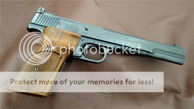

I bought this one some 10 years ago. It's made in 1969. Came with after market adjustable target stocks on it, but also had the original grips. Also came with 2 muzzle caps (I've since sold one on the forum) and 2 mags. It took me awhile to find out that it only likes CCI Standard Velocity ammo, but shoots great. I have also shot a Model 46 and a 41 made in 1987. All were wonderful.

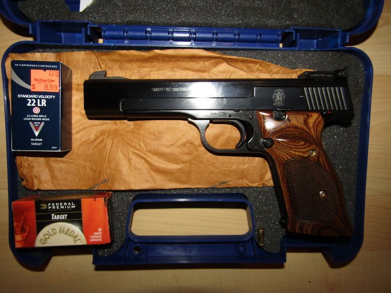

I have a brand new one. I've shot older models, they're great, no complaints. The thing is, my new one is super accurate, came from the factory with a 2 pound 8 ounce trigger, and so far has functioned flawlessly.
Negatives? It is a little more difficult to take down than the older versions, but I expect that will work itself out given time.

Marine24, beauty is in the eye of the beholder, and it looks great to me! Besides, beauty has nothing to do with accuracy.
BTW: I noticed the same person I got my 5.5" barrel from has two more listed on GB for under $300, which is a great price for a new in the box barrel.

Thanks Tom. I'm pleased with the purchase and looking forward to getting it out to the range.
Appreciate the info on the barrels on GB. Actually was thinking about purchasing one or possibly send the 41 off to Clark Custom for one of his barrels.
We'll see how she shoots first and adjust from there.
DAAAAAMMMMN that's a beautiful lookin gun !!! 😳😍.....sorry....I'll wipe up my drool now.
