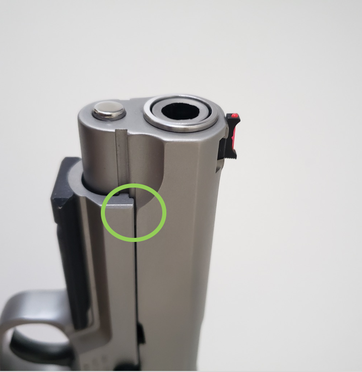

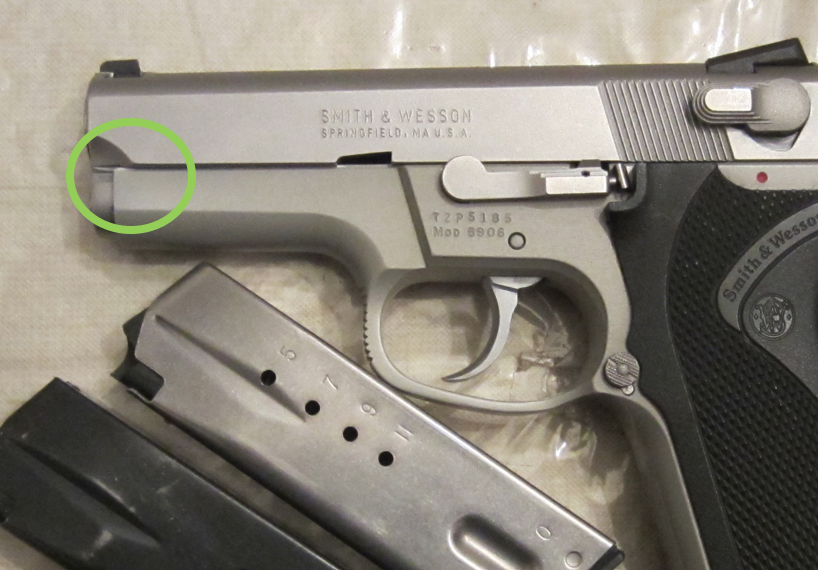

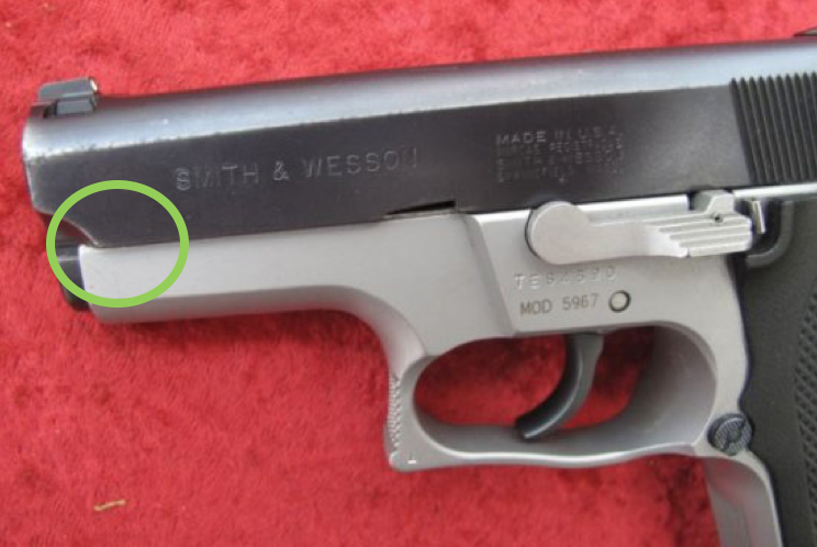

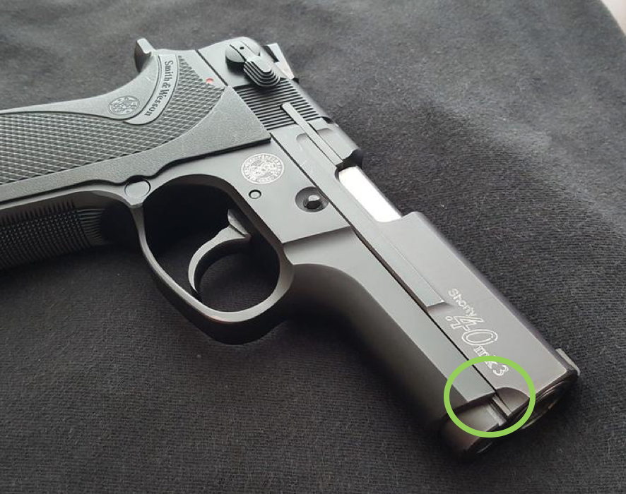

Originally Posted by guzzitaco
Misalignment concerns: I think I better tackle this in a separate post before we all get stuck in a "rabbit hole".
As I said in a previous post, to be totally honest, I never thought about addressing the slide/frame misalignment. I never paid much attention to it, since most of the 3rd gun S&W have it. And maybe it is kind of a "trademark" of a third gen.
To illustrate my point:
the M5967 that I am "inspired" by has it
also the M6906
also my beautiful M5906 TSW
even some Performance Center pistols as this Shorty45
However, there are examples that I found where it was "corrected". All are Performance Center pistols.
the 3566 compact
the fantastic Shorty40
One thing is certain, I do not have 1/10 of the skill of one of the Performance Center guys that built those guns...
I don't know if I should try address it, because after that I might want to address it in all my S&W...and I would be hard to do it in all since there are aluminum frame ones (like the M6906) that would need to be re-anodized.
I have to think more about it, before attempting to tackle it...
Maybe in the future...
Anyway, thank you for the feedback...never thought about it...
more to come...
