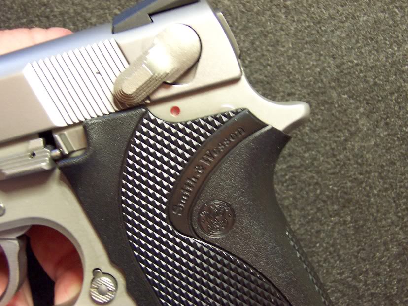

BTW, if you have to remove the 3rd gen grips enough to become familiar with the process, it's pretty simple. You do have to keep in mind keeping the side hooks oriented to catch the front of the grip frame windows, and not tweak/lift the sideplate at the front, keep the mainspring cup oriented so it remains in the grip backstrap's cup ... and make sure the top of the grip is fully forward under the rear of the frame (think tang).
It's a 1 minute off and 3 minute on process, give or take, taking your time and double checking you didn't let anything slip out of position.
Kind of a ... pull the front edges apart to clear the frame, but let them go inward to catch the front edges of the frame windows (or they get stuck on the outside of them ); slip the mainspring cup into place; rotate/"lift" the grip forward and upward, and forward and seat it into place, then drive the grip pin back in.
If the top of the grip isn't seated fully forward, you'll find out when you try to lower the safety lever, as it won't clear the top cutout on either side. The good news is that if it's just a little too far out of place to the rear, it can be quickly and easily corrected by grasping the grip in a normal grip and squeezing, as that will "push" the top of the grip forward to seat it.
Grip not fully forward at top after installation:
You can see how the grip is too far back at the rear, under the grip tang, and leaves too much of the front of the sideplate exposed.
Grip fully forward after squeezing it and seating it:
Sorry for the quality of the pics, but they're old and I've not had reason to make better ones.

Ok. Great pics. I had them oriented eight. Cross side facing up into the spring, flat edge of floor plate to back, lip towards the front. Should the lip be over the Mag body on the outside? I donít think so. If I do that the floor plate and butt plate can slide forward together. One of the metal plates doesnít even have the lip. Must have broken off at some point. But I figured it must stay inside the mag body.
Thanks very much fastbolt. Iím gonna shoot it a bit tomorrow and when the springs arrive Iíll change them out and shoot it again to test for function. I have a recoil spring and firing pin spring on the way, as well. I always change those out as well.
Yeah, the grip is always a bit of a deal to get off for me, but never like it was this time. Youíre right about the time, although I usually get them off in about 30 seconds and Iím in about 2-3 minutes. As I said, Iím fanatical about cleaning my guns so I used to take the grips off, but for the last few years I just donít use solvent in the frame to avoid making a mess. Just wipe it down with a clean rag and use compressed air after a wipe. But when I buy new they have to come off because of the nastiness I have found under there. The 4566 wasnít TOO bad but I just grabbed a 5946 that was an NYPD duty gun. It must have been a supervisor or detective gun because they generally didnít get hassled to clean the gun after a qualification and it honestly looked like the gun hadnít been cleaned in 15 years. Filthy top to bottom and in every crevice. Magazines too. It was nasty. You donít recommend removing the grips that often, do you?
I ordered a set of Hogue panel grips when I was struggling with the factory ones. I know theyíre fatter but at least I wonít have to deal with it.
The way I install the grips is to spread them to get them on the frame, slide them up and in while avoiding the side plate. The cup is already on the spring and as I push the grips in I am pressing down on the cop with a punch until it slides over the grip and snaps in. Usually takes me a few tries but this last time was frustrating.
The front upward pointing lip/tab of the insert must always be on the INSIDE of the mag body. It keeps the insert properly positioned under the spring and helps keep the buttplate on the mag in the correct position.
FWIW, I've occasionally had to help someone disassemble their duty weapon 3rd gen mags after they'd incorrectly assembled them so a (steel) insert tab was stuck on the outside front of the mag body. That little extra thickness of metal caught between the bottom edge of the steel mag body and the inside floor of the mag buttplate could create some interesting extra tension when trying to pull the buttplate off the mag body.

Originally Posted by BLUEDOT37 View Post
That is a Wolff magazine spring & the angled up top coil is normal on them.
My picture is from years ago but you can see the tired S&W mag spring along side the new Wolff mag spring.
I believe the Wolff XP mag spring has one more turn to it.
Can open, worms everywhere.

I couldnít stop wondering so I went to my outdoor range. Took 110 of my 230 grain reloads. 8 of them were plated and the others were lead. Both round nose.
Fired mostly fine. One magazine had an issue but only that one time I used it. Other 3 times I used it no issues. One time the slide didnít fully go into battery. I ejected the round and re-seat it. Chambered that time. About three rounds later the round didnít enter the chamber. It was just beginning to enter when it hung up. Ejected it and tried again. Chambered and fired. Other two mags no issue.
Gun was accurate. At least as accurate as I am. Truthfully, I shoot my M&P .45 2.0 better. But I like the 4566 better. Just classier I guess.
So it might have been my reloads. I had issues with the lead not wanting to chamber in the M&P .45 last week. People here told me to seat them a tad more but Iím just trying to use them up at this point. They seated fine in my government 1911.
One thing I noticed is the trigger is ďclickyĒ. A pronounced click when itís fired in single action. Nothing in double.
The new springs are coming on Monday. Iíll put them in and head back to the range. See if thereís any issues. Just for giggles I loaded a couple of spent casings. Fed perfectly as I expected.
