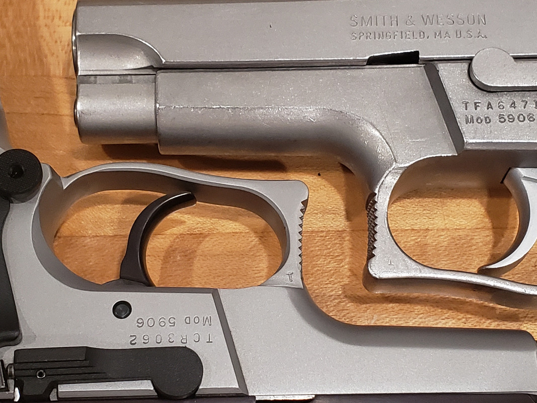

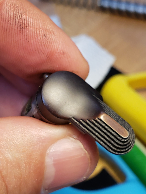

With the cutting and filing I have done (I rounded the hooked trigger guard), my desire to checker the front strap, and the upper cut I want to add under the trigger guard, I think its prudent to have the frame blasted and re-anodized. In fact I am going to have it anodized in Mil-Spec Type-3 Hard Coat. I am fortunate in that I "work" a few days a week in a gunshop/manufacturer that can offer this service. When it comes back, then I'll decide whether to Cerakote it (we have this capability too).
I will also blast and Cerakote the slide. Before I do that, I'd like to add front cocking serrations, top strap serrations, and in a perfect world, lightening cuts in the slide. ("If you think classy, you'll be classy." - Crash Davis).
I am sourcing a decocker only lever, and kicking around having the finishes side of the shop do their Nickel Boron coating on all the internals, but also the controls, guide rod, and mmmmmmaybe the barrel.
I carry a Glock G45 everyday (basically a Glock 17 frame with a 19 slide), and this would be my S&W 3rd Gen version of that, even thought the SSV predated the G45 by almost 30 years.

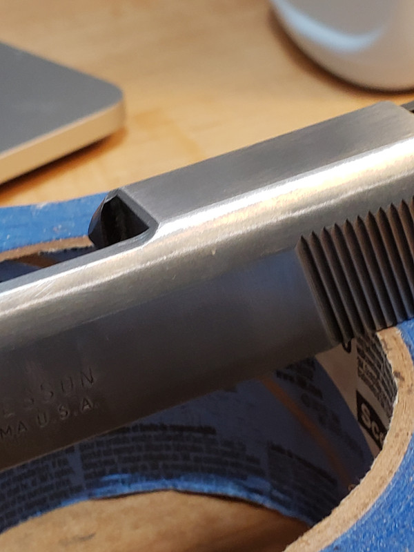

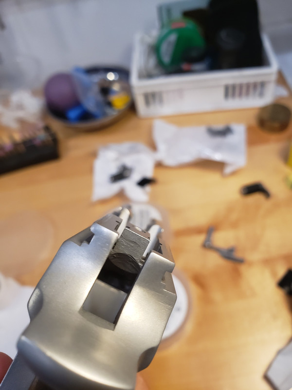

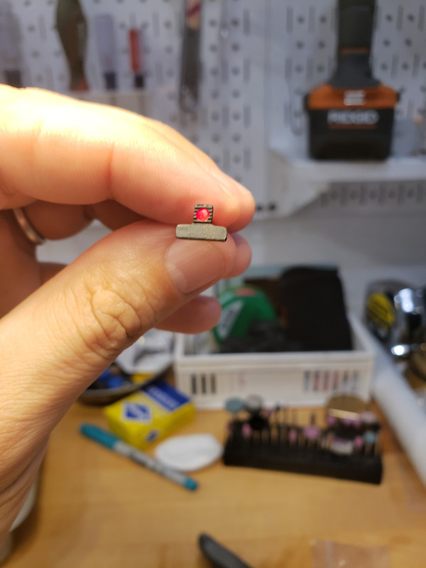

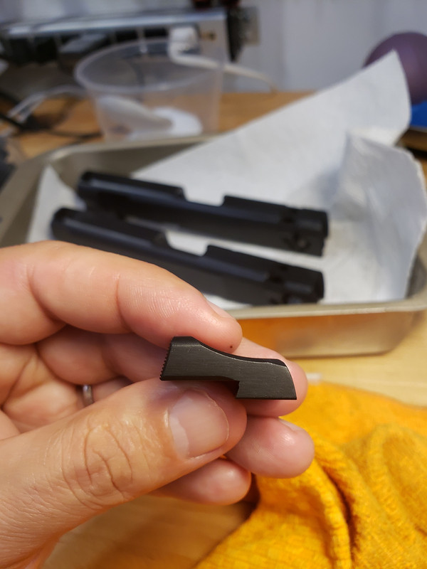

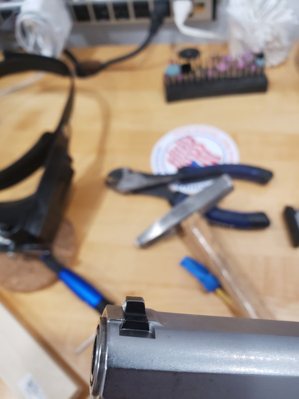

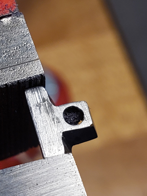

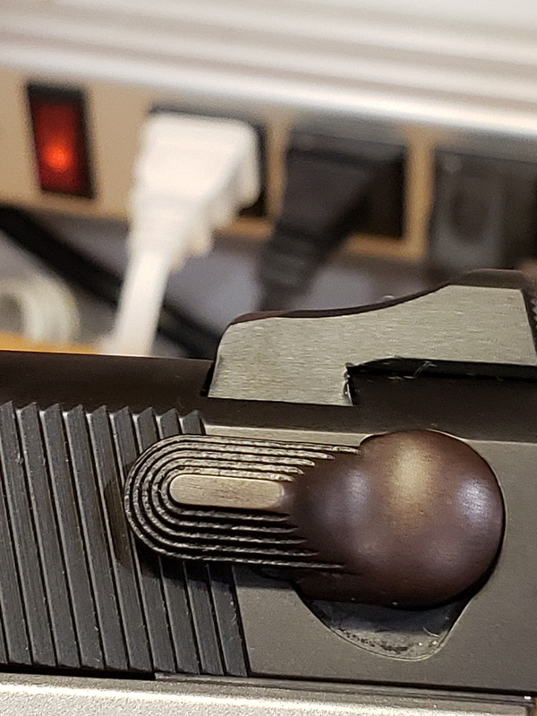

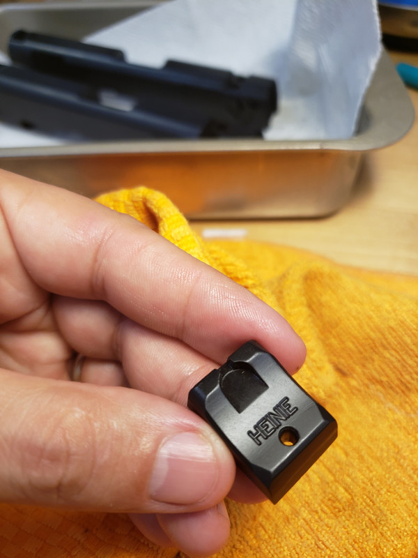

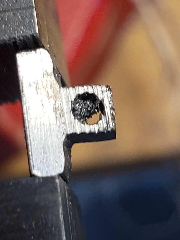

Fitting the new rear sight:
I bought a different sight. I got a Heinie Slant Pro low profile. It was the same height as the Fusion but had a "smoother" profile. The sight was on sale on Heinie's website for $25 and shipping was $2 for a total of $27. A company officer attaches her business card to the order in case there is an issue, you can email her directly...I like this company...and I like the sight...a lot.
This time I took my time and used duck tape to protect the spaces I did not want to hit with the file. Also, the duct tape created a "ledge" that I could use to lean the file against and be more precise.
To avoid any dents and prevent the sight for flying and landing on the floor, I used a small piece of wood to drive to sight in and out. That allow me to have better control of the situation.
This sight has a bit more meat than the Fusion, that helped the small gap between the sight and the slide to disappear.
I must say I like a lot how it looks and I believe the sight acquisition would be great.

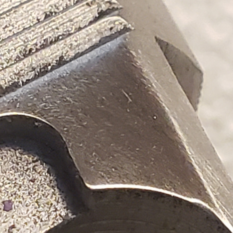

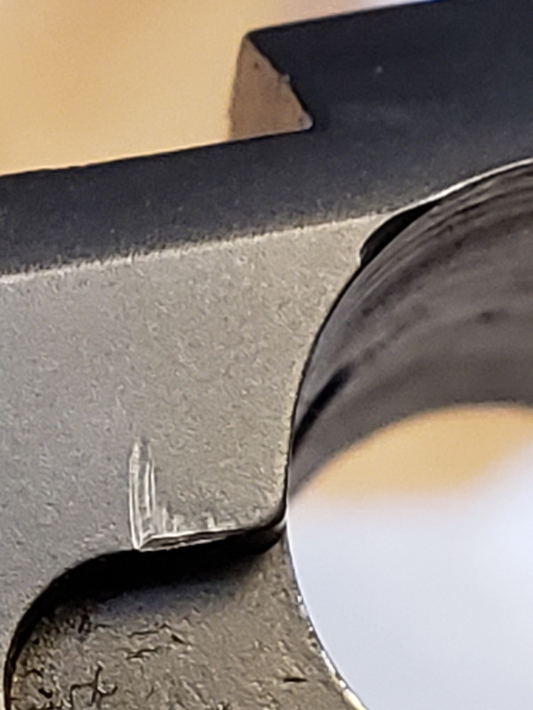

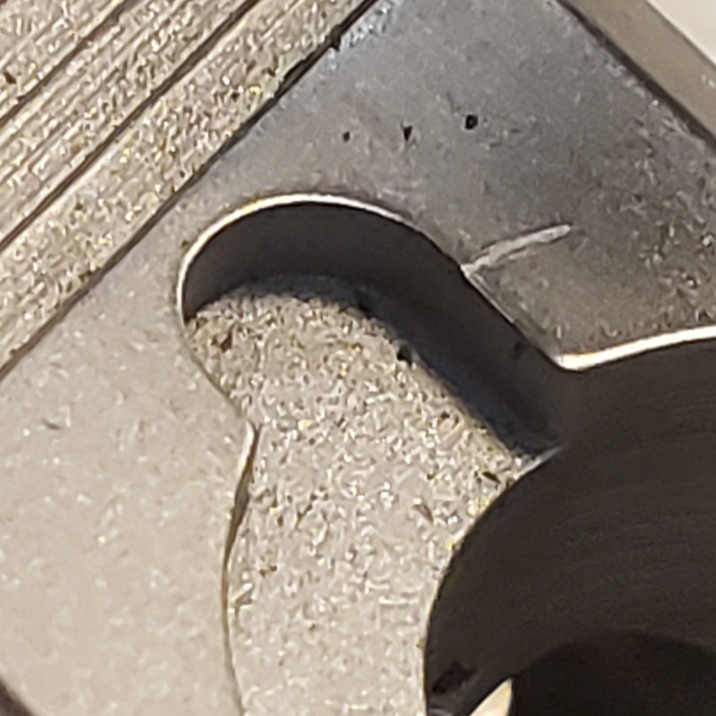

I started to remove as many marks and imperfections from the slide as I could. I did it carefully, trying not to create a bigger mess than the one I was trying to solve.
Used stones from 600 grit to 1000 grit.
I tried to be careful not to distort the "lines" of the slide
There were some deep marks that bothered me...
So, I did the best I could in them...
Mistakes, mistakes, mistakes...
One night I had a heated argument with my 15 year old daughter, and I got really angry...the best idea I got was to get a beer and "go work on the slide". I was trying to square the flats by sanding them using a marble block using 400 to 600 grit paper...I must have been really mad, because I stroke it so hard that I started to erase some of the roll marks...
That night I went to bed furious...
I erased a bit of the E and a bit of one S. Next day I took it to some local engravers, but none of the could fix it, they wanted to re-do the whole thing and it wasn't an inexpensive job.
I was tempted to erase it all, and have a clean slide. But decided to leave it like that. I will be hard to notice with the "naked eye" and it will serve me as a reminder of not to work on projects when I'm mad.

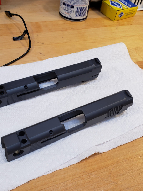

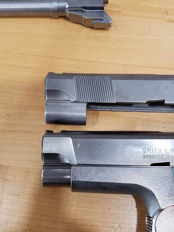

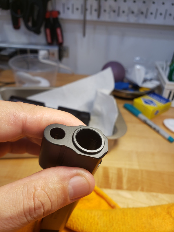

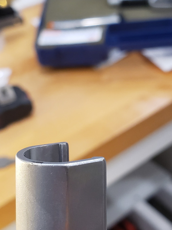

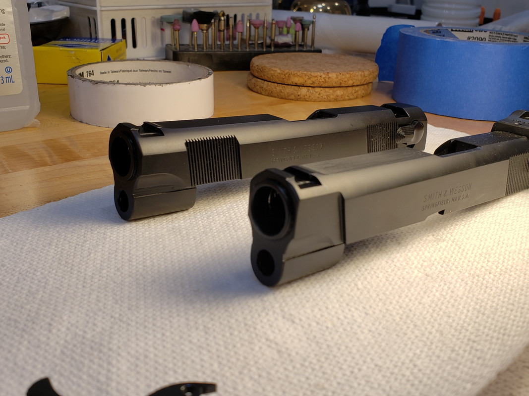

After fitting the sight, and getting ready of the "pesky" marks around the slide (most of them, not all)
I started to think about doing some carry cuts on the front of the slide.
There was a project by Squidsix some time ago that I liked a lot:
Hi Power cuts on 915 slide
So, something like that but maybe "shorter"? I started to look around the internet for some inspiration...
Perhaps something like this?
I decided to give it a try...
(bench vice, wood blocks and a file)
(kind of complement each other...)
(Trying to imitate a Performance Center Slide)
(real Performance Center)
I really liked them...
I decided to make them a bit deeper...
Slide #2 was starting to take form...
more to come...

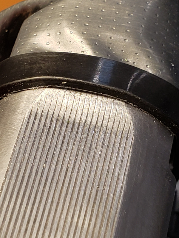

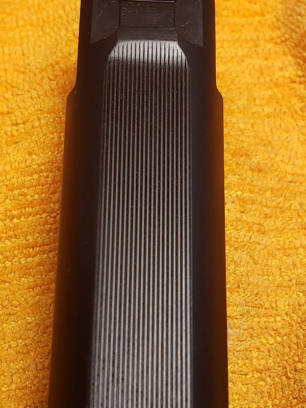

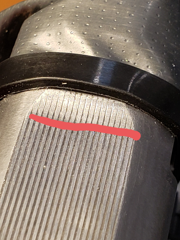

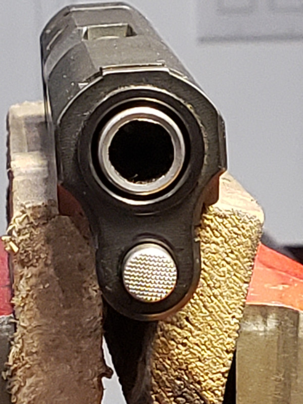

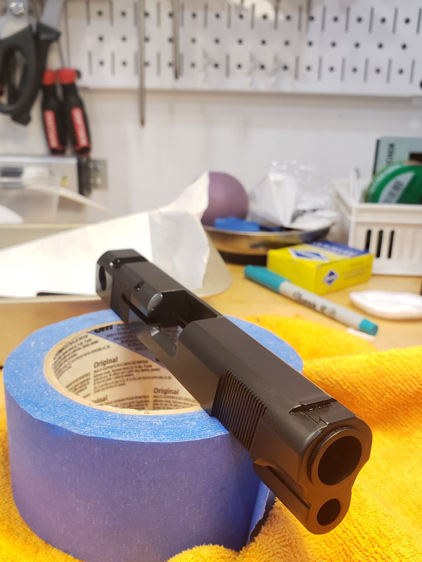

Top Serrations?
I have seen top serrations on many custom guns. Again, like front serrations, none of my guns have them (I don't have any customs). I understand they reduce glare and let you focus better on the front sight...
...so, I decided to give them a try, after all I have already made a bunch of mistakes...
(I used sharpie marker to help me see better the lines, the zip tie was meant to act as a barrier protecting the front sight area).
(notice the golf ball handle )
(decided to cut the checkering file. I was too long and somehow I was hitting the area under the rear sight. I was concerned of creating a "gap" under the sight.
(it was hard to decide hot to "finish" the area where the top of the slide and the front sight area meet)
(some more protection, I really didn't want to damage that sight area)
(some testing with the rear sight installed)
The I decided to do some bevels to reduce the sharp area after the carry cuts. I tried to do the similar to what S&W used to do. I find this complicated, since it is hard to keep the "angle" consistent on both sides. This time I put a cork inside the barrel bushing and used it as a guide.
(dark area around the front of the slide is surface rust from sweaty hands, remember it is a carbon steel slide that will be blued)
more to come...

How did you get the serrations to properly follow that little ski jump leading up to the sight? Parallel, in other words. It seems like the file would lose its alignment when it lifts off the flat surface of the slide top.
This is amazing work, by the way.
Hi Dentt42,
thank you for you kind words...
I will try to explain how I did it (sorry if it is a long explanation)
The truth is I was going to stop the serrations before the "little ski jump" (don't know the technical name).
I wanted to finish in a straight line where the red mark is. I used a zip tie to limit the file strokes and end there in a perfect straight line. However, the zip tie that I used was too thin and/or I pushed the file too hard, broke the zip tie and marked the ramp all the way to the flat top of the sight area. I didn't do it once but several times.
I though of erasing the marks, but I was concerned of creating a "curve" or a "dent" on that area that would look odd (and damage "the ski jump").
Since the marks where really thin, looked like "hair lines",I decided to make them bigger with a needle file I bought at Brownells some time ago (and that I almost never use).
I did this slowly and carefully, taking my time.
Then, I used the piece of checkering file that I cut, to deepen the lines and try to blend them with the others. Despite being rectangular, the file "cuts" at an angle. Since the lines where already made "thicker", that served the file as a "channel" or "guide" to keep the straight line...
I left several marks that I later cleaned with some stones and sand paper... (had to repeat the process a few times).
I am sorry I don't have better pictures of the process. I thought of recreating some of the pictures with the actual slide, but it is already blasted and cleaned, just waiting for some good weather, so I can do the hot bluing...
At the end, this was a mistake that luckily ended looking ok. However, I think that if I was going to do it again, I think I would finish in a straight line just before the "jump"...
hope this helps...

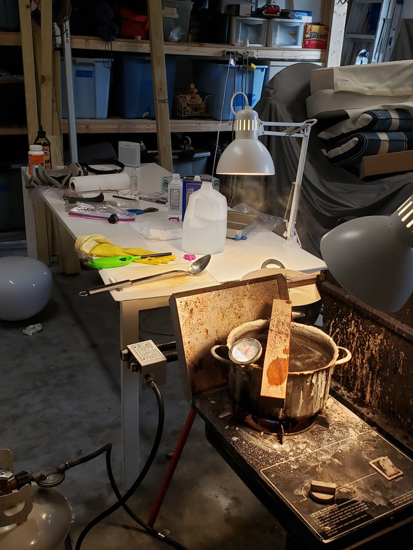

In the middle of it all, I bought a blasting cabinet.
it wasn't new, but it was only $20. It was much better than the plastic cabinet I "build" out of a container...
After a lot of cleaning, and degreasing; I had to make a new suction tube and change the hoses, spent an extra $8. (should have changed the gloves...)
With the new blaster, I was able to do make faster progress and work more comfortably (I guess I used it on the other slide to, but I forgot to mention it )
I fitted a front Dawson sight...at $39 is a bit pricey, but I like it a lot...
The sight has a lot of "extra meat", so fitting takes time. I did an ok job this time.

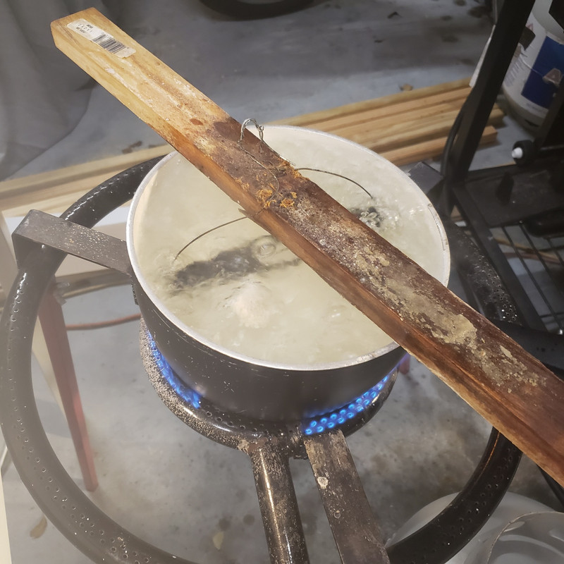

Originally Posted by cherrypointmarine View Post
This thing is turning into a work of art . What kind of finish are you going to put on it ? Or are you going to leave it with a bead blasted look ?
You need another 5906 so you can put them side by side and show off your work .
Thanks a lot...
I will do hot bluing (at home) in all the carbon steel parts. I am getting ready to start this morning...
Great idea...I have a 5906 "un-moslested" SS complete slide. I will take some pics...

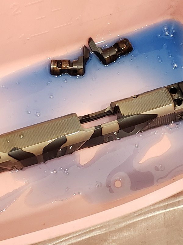

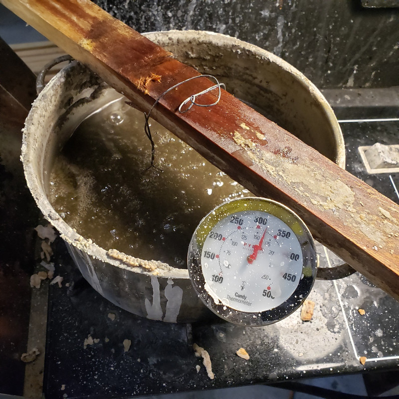

Hey Froggie...spent a lot of time today doing bluing before the rain hits...
We are getting close...

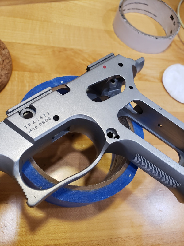

The frame (now frames...)

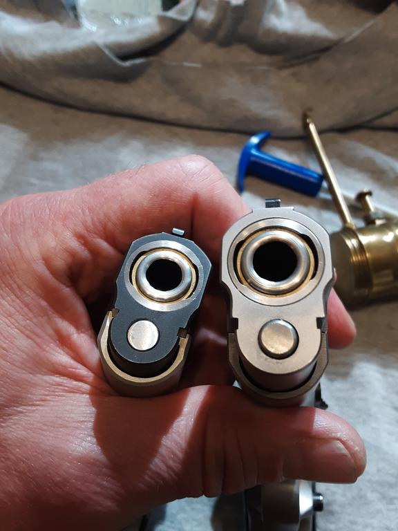

I didn't have a frame for this build. My initial intention was to use the RMR slide on the SSV (Frankengun) frame. However, I added another slide (when I was looking fora barrel) and ended with 1 frame and 3 slides....
I decided to get another frame...
To finance the purchase, I sold my gorgeous model 10 (here in the forum for $400). Luckily, on the same week, I stoped by a gun store close to home and found a M5906 for the same price...
Unfortunately, it has a narrow hood barrel, is I can't use it on my M915 slides. But, it is a beautiful square trigger model...
I suspect this was a police trade-in, but there are no markings, so I'm not sure...
Also, it was in poor condition, dings and scratches everywhere...
(comparing the new frame with my SSV Frankengun frame)
The front sight was heavily damaged. It was a meprolight night sight that was dented and cut, to get the tritium tube removed.
So, it wasn't the greatest find...but it was mine

Doesn’t the 915 slide you got from me have the narrow slot for the barrel hood? That should work with the one you got with the 5906, shouldn’t it? BTW, I’ve decided I need a slide with sights like ‘57 Chevy tail fins.
Froggie

Yes, the M915 slide I got from you has a narrow hood, so it would fit the M5906 barrel...
...however, I am reserving that slide for another build Xmas break...Netfix is horrible those days... (and having project is the perfect excuse to hide in the craft room avoiding some "relatives")
PS: I also like those slides with the adjustable sights and metal wings...however, all the ones I've seen have a HUGE roll mark on them...not my favorite...
But...I think one of those slides could be modified to mount an RMR directly on the slide, thus lower than with a mount...(one of these days)

Initially, I played with the idea of adding a light rail.
I didn't realized how slanted the dustcover was. I didn't want to modified it, since that area is already "thin" and I also don't have the equipment to do welding (I also don't know how to weld )
So, I abandoned the idea and returned the rail. Lost $10 in shipping...
Some work on the frame:
I tried to remove most dings and imperfections from the frame, before the initial blast. I also addressed the area in the back , so the slides with serration and the frame would "blend" better.
(as you can see, I still have some work to do in this area, some filling marks still show)
(also started to work in some beveling on the front of the frame)
(it was getting better...)
Some other details:

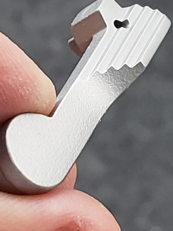

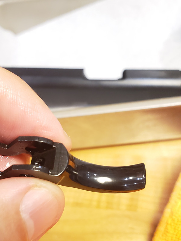

The slide stop was banged and scratched. It also had a ding next to the pin hole, maybe when someone tried to remove the pin they dinged it.
So, I did some work on it:
(after a trip to the blast cabinet)
Looking for a front sight for the RMR slide:
the RMR slide needed a back up front sight. Since the RMR (Sig Rome Zero) has an integrated rear sight, it would be ideal to have a front sight that would align nicely.
However, funds are scarce these days...so, could I work with what I have? After all, it is a back up slide and I is meant to be used at the range only (or mostly...)
This is the front sight that came with the M5906. The one that is dinged, dented and cut. I think it was a Meprolight night sight.
It isn't pretty, but it is close to the ideal height...
I decided to do some work on it...
(removed the glass, tritium tube wasn't there when I bought the pistol)
some filing to "square" it off...
some front serrations to make it look less "bubba"
The rear sight:
Every time I fit a rear sight, I do some marks on it. It doesn't matter how hard I try, I always do a scratch or a mark with a file.
I decided to removed the marks and re-blue the sight
more to come...

Been working on the rear part of the "former" SSV frame with the goal to get a better blend with the slide (the one with the front cuts).
(sorry for the mess at the end of the room, I was having a fight with some sandpaper boxes )
At this time I have decided that the RMR slide will belong to the new M5906 frame and the slide with the cuts will belong to the SSV frame.
I think the slides are ready for the final blast. However I am looking for a couple of parts and I don't know if I will be able to assemble both of them at the same time.
In the meantime, I have kept doing some experimentation with the checkering files.
(this is the M915 slide I recently acquired from Froggie. The guide rod is for another model, but before cutting it to fit, I made the practice run..)
I like the checkering a lot, but I am not sure I like it on this build.
more to come...

Frame preparation and blasting
Kept working in the rear of one of the frames, to completely erase the file marks.
Used an acrylic rod with sand paper, the idea was to keep an uniform pattern that would have been hard to achieve with bare hands.
It is a bit rudimentary, but it works...
I removed the "black goo" from the magazine catch and magazine catch nut. They are stainless steel, and I have decided I want the frames totally "stainless" color.
(This lysol works wonders to remove bluing and black oxide, but don't leave the parts inside more than a couple of minutes !!!)
(also decided to blast the trigger pin, these are SS)
After a blasting session...
(some greasy spots from my bare hands)
Ready for some hot bluing...
more to come...

Default Hot Bluing blues
Hot Bluing Blues

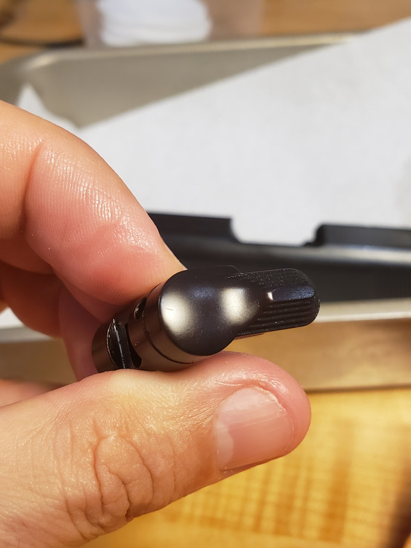

I waited a long time to do the hot bluing. The weather was not cooperating and it had been raining for weeks. I like to work in the garage with the door open, but when it rains the water comes in.
However, tired of waiting for a better weather, I decided to go for it. It was a Friday afternoon and it was going to rain the entire weekend.
So, I decided to set the garage "LAB" in a different way, closed the garage door, but opened the 2 windows and used 2 industrial fans to dissipate the heat and fumes.
Foolishly, I decided to "cook" both slides at the same time. HUGE MISTAKE. My bath is small and does not hold enough solution to "attack" with slides at the same time. This would have consequences.
Also, by the obsession of taking pics, I kept the slides to long out of the bath. This "stains" them, when the residual solutions dries on them.
took them out the bath, boiled them in water for 10 min and then oil them for some hours.
At first glance they seemed fine, but a bit latter I started to notice some issues.
SLIDES WERE NOT THE SAME COLOR !!!
Also, the safety was a different color than the 2 slides.
Safety was brown-bronze color.
(also, realized the sight wad a couple of "dings" that were not properly addressed.
(comparing the slides with my "unmolested" M457 slide)
The decision was easy. I would re-do it. The bath was already set in the garage. Next day was a Saturday. It was raining, and there was nothing better to do. (I must confessed I was very frustrated).
I knew one issue was "cooking" the 2 slides together in a small bath. However, I couldn't explain what was going on with the safeties.
The safeties I am using are from a 39-2, so I assumed they are from a different steel alloy than the slides.
Did a ton of research that night. Found a video on you tube (I later posted it on the thread "hot bluing at home" in the gunsmithing section of the forum). On the minute 41, the gunsmith talks about some Winshesters receivers being hard to blue because the steel contains some traces of nickel and as a result they turn a different color. He also explains that this steel must be "cooked" at 310 degrees F instead of 295F to obtain the back color. (I found this around 2 AM, when I couldn't sleep).
So, I decided to assume my 39-2 could have some nickel in them and I will "cook" them at 310F.
Next day, I boiled the slides on a solution of water and simple green to remove all grease before re-blasting.
Why is water boiling at 225F degrees? Water boils at 212F (my house is at sea level).
So, I discovered another issue. My thermometer was busted. My bath was at the wrong temperature and was not working properly.
slides after de-grease
Lots to fix the next day. Had to start all over again.
More to come...
PS: I will re-post these findings, with more technical detail, in the "hot bluing at home" thread in the gunsmithing forum.

Bluing redux
The next day was a Sunday and we were expecting a tropical storm. Heavy rains were scheduled for the entire day.
We spent a few hours preparing for the storm (and getting some stuff inside the garage)/
I wanted to finish with the bluing, so I decided to lock myself up in the garage and work on it.
I changed my setup a bit, and included a water boiling station, so I wouldn't have to run to the kitchen to boil the parts in the middle of the rain.
I also added more lights and another fan.
I decided to "cook" the slides in 2 batches, not to weaken the bath. I also used a digital thermometer to make sure I was in the 292 to 295 F range. I was extra careful with the timings making sure all the parts would spent exactly the same time inside the bath.
Didn't take any pics during the bath, not risk "staining" the slides by keeping them too long outside the bath.
Things were looking promising after the water boiling session.
I also did the extractors, the sight (after fixing the ding I hadn't seen before), a hammer and some parts from the SSV project that I was expecting to re-use in this project.
Also, did the safeties, but this time I "cooked" them 1/2 the time at 295F and 1/2 at 310F. Only one caveat, I didn't remove the previous bluing. I cleaned them well, but left the previous bluing. This was a mistake.
After a couple of hours in oil, I was happy with the results...
All parts were the same color. That night I was a happy camper...
Little I knew there would be trouble ahead...
more to come...

Later the same night...
I was so happy that I stayed working that night.
Things were looking fine...
(please note the "serrations" slide has a matte barrel bushing)
(trigger and hammer from the SSV project were re-blued at the proper temp. Please note the polished blue finish)
(safeties were now the same color as the slides)
(top serrations were looking fine after the bluing...)
(please note the "semi-polished" barrel busing in the slide with the front "cuts")
(rear sight was looking fine, same color as the slide)
(no dings I could notice...)
(the sight made out of the "damaged" front sight was looking fine. It wouldn't blue, maybe it is made out of nickel?. I decided to coat it with aluma hyde. Found a fiber optic 2mm rod, and after various attempts, I manage to "fit" it in there.)
I decided to start putting together one of the slides...
The rear sight was trouble. The springs that got under the sight would get tangled in the cavity surrounding the hole for the screw...it was a bit of a nightmare to get in there...it was one of my "clumsy" days...I damaged two springs in the process...
Changed the fiber optic on the dawson front sight to yellow. I like it more and I wanted something what would emulate a "golden" color from a classic build.

Ok...here is what happened. When I decided to use the safeties from a 39-2 model I assumed they would fit perfectly. I tried the safety in one of the slides and had no troubles. So, I assumed the other safety would work fine in the other slide...WRONG !!! (these pieces were not cut with a laser...)
Safety was really, really hard. Was rubbing against the top and it wasn't possible to operate the pistol like that.
Worst thing...it was stuck...took me a long time to take it out...and in doing so, I SCRATCHED THE SLIDE ...!!!
Also, alert handing the safety for an hour or so (manipulating it hard)...the top black (dark) coating of bluing came off and under it...THE UGLY BROWN COLOR !!!
(At this point in time I screamed and my wife came to check if I was ok)
Here is what I think happened: remember I didn't removed the bluing from the ugly brown color the first time? I just "cooked" it in the bath and only 1/2 the time at 310F.
Well obviously it wasn't enough time and temp and the "dark black" coating was only a thin layer that came off after heavy use...
The scratch was deep and there was no way I was going to leave it like that...

I removed the bluing from the scratched slide AND the safeties
everything got cleaned and blasted
got the bath ready
deep scratched needed to be addressed
got it fixed...
rinsed after the "bath"
boiled after the rinse
oiling after the boil...

I let the slide "marinate" in oil for a couple of days. I guess the reality is that I was scared to scratch it again and scared that the bluing of the safeties would "rub-off" again...
At some point in time I decided to take it out of the oil to see the results...
I decided to install the extractor...
this time I was drinking Coke
I re-blued the extractor pin
also the extractor...
everything work with no issues...
Since I need a spring for the firing pin plunger (I damaged the 2 extra I had). I decided to wait until the parts arrived and not touch the slide anymore...
I started to put together the frame for the RMR slide.
(I like a lot the whole frame in SS)
Then I decided to "man-up" and finish the serrated slide...unfortunately I was to stressed and so concentrated that I didn't take any pics...sorry...
...but here is the pistol assembled...
(some oil left in the front serrations)
The extended slide stop (Ed Brown) was a gift from 4T5GUY (Jim). I like it a lot...
(some grease sticking out...)
I hope you guys like it...
