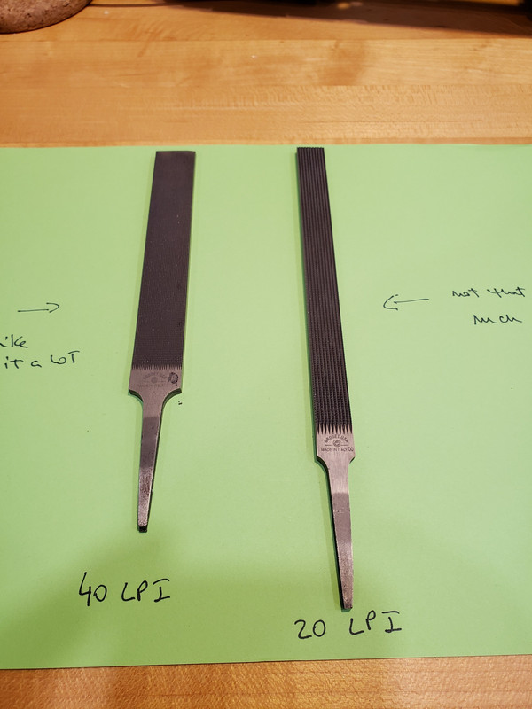

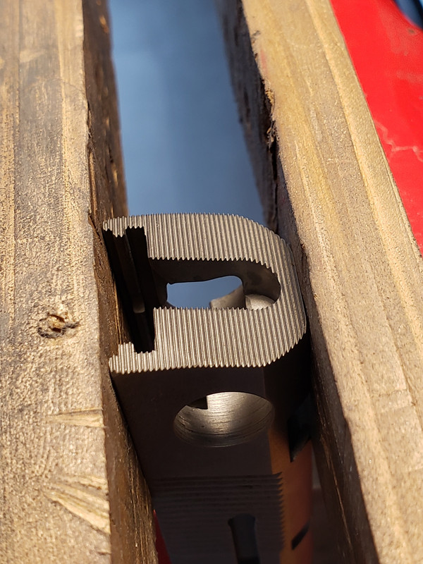

Rear Serrations:
I also wanted rear serrations, I have seen them in 1911 builds and I always like them. Since this was going to be a slide for the range, maybe I could experiment a bit on it.
So, bought a 40 LPI checkering file on Amazon for around $34 and after some practice on scrap metal, I decided to start working on it:
I liked a lot how they looked and even though it was a lot of work it wasn't that difficult...
So, could I make serrations inside the front cuts?
I ordered a 20 LPI file (this time from eBay, cheaper, but took a long time to get here, and I think it is not the same quality). I know the front serrations will not have the "angle" that the rear serrations have, but it was the only way I could think of doing the without a mill and making sure they were straight.
After all, it is a "range" slide...
It was late when I finished the first side, so I decided to make the other side the next day...later this would prove that it was a mistake...but that night, I was a happy camper
more to come...

Next day I started to work on the serrations on the other side. Even though I was rested I wasn't in the zone. I had completely lost the "rhythm" that I had from the previous night.
I don't exactly know what happened, nor documented the whole thing with pictures, but the lines started to get different "widths". They were straight, but some were "thinner" in the extremes and "fatter" in the middle.
I think I was "pushing" the file at an angle and didn't realize until it was too late. The only solution was to "erase" some of the checkering and start again. I was tedious and stressful. I didn't take it well. After a lot of work, this was the best result I could get:
It wasn't perfect. Using checkering files isn't easy. I thought that after some work on scrap metal and the rear serrations, I was ready and got over confident. Also, I believe that the cut on the side of the mistake wasn't even. The checkering file would "eat" the metal at a different angle if the surface isn't straight.
I kept working on it for the next week or so. Little by little. Small sessions. Trying to "straight' everything out.
Things got better:
After some more sessions and some blasting, this is where I got...
They are not 100% perfect...but they are close. After the bluing, I think it will be hard to spot the small imperfections without a magnifying glass...

Thank you Froggie...thanks for all the help and the support and for all the parts...
Some pics that might help in your endeavor...
I put the slide own the vise between to wood blocks. Make sure they are straight, or your checkering could be at an angle . I am a bit clumsy, so I tied the slide to make sure that if I accidentally drop it, it does not hit the "kryptonite" floor.
Leave enough space for the file to lean against one of the blocks. the idea is to use it as a guide.
I use both hand for this, but I was holding the phone to take the pic
Cuts should be deep enough that mark the edge, but the deeper the cut, the "thinner" or "shaper" the edge of the cut, so it is more brittle and can break if you push too hard. Try to go little by little and check your progress constantly (I normally fail at this).
I don't own a file handle, so I use an old golf ball I found. It works fine.
I recommend a good light, shadows are a problem for me when doing this.
I am loosing my sight, so I need magnifying glasses.
Grobet checkering files come in two widths, I have found the wider easier to use. For specs, you can visit their website.
Hope this helps...

Likes: 498
Liked 671 Times in 155 Posts
Default
Originally Posted by Erocksmash View Post
I'm going to be running some carry drills this weekend with the Shorty.40 and depending on results and weather she will be introduced into the rotation, I would like to explore some of these improvements and applying the to said gun....
What did you search for or what kind of hand files did you end up with ? Just a basic search?
Hi Erocksmash...
The Shorty .40 is one of my "Holly Grail" guns... (as the 5906 IDPA, RECON 9 and others)...
I think it is a good time to disclose another issue I had, due to the rear serrations, that I was going to address when discussing the "frame" section. But since we are here...
The fit between the rear portion of the slide and rear of the frame is important. Many gunsmiths (builders) take good care of this, by making sure there is a perfect match (blend) between the two. If you take a look at BMCM builds, he is very careful in this section.
Check this thread (post#1)
We're way beyond Dremel now, Melted & Melonited 4516-1
(Also, it is worth saying that in terms of 3rd gens gunsmithing, he is Yoda and I am not even a Padawan).
So, when you are doing rear serrations to your frame, you are "eating" material, the rear of the slide has a curve frame, that you will be flattening a bit, by doing serrations. The deeper the serrations, the more you are altering the shape.
That "new" shape after the serrations will match the frame in a different way, so you might have to alter the shape of the rear of your frame if you want a perfect "match" or "blend".
Some pics to illustrate the issue:

I
Hi Erocksmash,
sorry for the late reply to the original question.
My interest with checkering started after I read some of BMCM threads, where he fixed or starts from scratch some checkering in the front of the grip of the frame. I wanted to fix that area on my 5906, but since there is a curve at the end of that area (close to the mag well), it is not possible (or not easy) to get a checkering file there.
Since I like the idea of customizing my pistols (project guns or frankenguns), I started to lurk a lot around the 1911 forum, since it is a common platform for customizing and there are a lot of them. The Grobet files were mention as one of the tools of choice and I saw different pictures of different patterns such as 20, 30, 40 and 50 LPI.
Grobet has a good website with some info.
Grobet USA Manufacturers and Distributors: Swiss Pattern Precision Files, Jewelry Tools, Industrial and Dental
This is the one I choose for 40 LPI:
Grobet USA Swiss Pattern Precision 6" Checkering-Hand File, Cut 1, Item No. 31.037 - Grobet USA
I have read that sometimes the files come with some defects from the factory and it is important to check them or test them before starting to work with them in the "real" project. So, I think it is also important to buy them from a vendor where you can return them without much trouble, in case they are defective.
For the 20 LPI, I bought this one:
Grobet USA Swiss Pattern Precision 6" Checkering-Pillar File, Cut 00, Item No. 31.040 - Grobet USA
I made the mistake of buying it on eBay, and I'm almost sure that is some sort of factory 2nd. So, I should start by following my own advice...
(I cut the 40 LPI file, to be able to better fit it on one spot, more on this later...)
There are some videos on youtube or on full30, from a guy called Mosing Virus...he is really good with files and I have learned a lot by watching him work.
On youtube there are other vides by a guy named wolf83...those were helpful too...
hope this helps...

Why a 2nd slide?
I wasn't going to buy a second slide. The initial idea of the project was only one slide for the RMR. However, when I bought the slide, it didn't come with a barrel. Spent weeks trying to find a wide hood barrel for a "reasonable price" (I don't know what that is any longer), and couldn't find one.
A website that I like a lot (and that sells every gun part) was running a special sell of 25% off and free shipping. So, I got a whole kit for $167.
I sold some parts online, gave some away, and sold the one side stainless safety, the remaining cost was around $30. Not bad for a barrel and a slide. Found a carbon steel saferty (39-2) online for $14. So, the total cost was $44.
So, I had an additional slide to play with. I wasn't 100% sure of what I was going to do to, but I knew I wanted a different rear sight and serrations in the back...
Rear sight:
For this slide I wanted to use a 10-8 or Fusion type rear sight. So, I needed to cut the rear of the slide, to accommodate it, again using my files, wood blocks and bench vise.
Another mistake here: I was advised by BMCM to cut the slide for the specific rear sight, so it would be a perfect fit. Since the Fusion rear sight was taking too long to arrive, I decided to tackle to task using the S&W rear sight as a reference...BIG mistake. I ended with a tiny gap under that sight that could have been avoided (and that would be fixed later by another mistake )
Fitting the sight:
The Fusion or a 10-8 sight has a Novak cut that is wider than the S&W dust and at 65 degree angle, instead of 74 degree. It is HARD to fit.
The sight is small, and when you use the file you might hit and spot that you did not intended to touch. There is a LOT of material to remove and you need to be very precise (also you need to know where to remove the material, so unless you have done this before or seen somebody doing it, it will be hard).
For more on fitting a 10-8 sight please see this thread (and read it carefully):
10-8 rear sight on a 3rd gen pistol?
My first attempt was a disaster and to make matters worst I dropped the sight on the "kryptonite" floor several times, resulting in dents all over it.
So, the sight was "tight" in it place, but it was dented and it had a lot of gaps that shouldn't be there. I was disappointed and angry after having wasted $40 in the sight...but I was learning...so, I ordered another sight from another vendor and in the meantime decided to tackle other tasks.
Some more rear serrations:
I decided to do rear serrations to this slide, after all, in this slide with the rear serrated sight is where they will be of use.
(black stuff is sharpie marker)
This was the sight picture that I wanted...too bad it didn't work out as I planned...
Removing machining marks at the tp of the slide:
This slide had severe marks on the top. It was also a bit "crooked", like it wasn't cut properly by a machine.
Spent some time removing the imperfections and had to remove a lot of material.
more to come...
