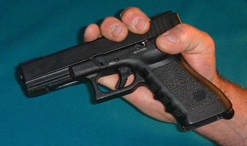

Ethangís post and method is pure magic for folks who have never done it or didnít know they could. The leverage that you get with this method can be a game-changer.
It does occur to me that it is difficult to describe this well with the written word, or perhaps I just find it difficult to comprehend when it is written. In the spirit of that, here is a picture that might help:
Sincere apologies that it is a Glock in the photo, YUCK, but it is what I could find quickly. Held in this manner, you have a fantastic grip on the pistol and squeezing as if you were trying to make a fist draws the slide back a bit more.
