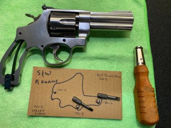

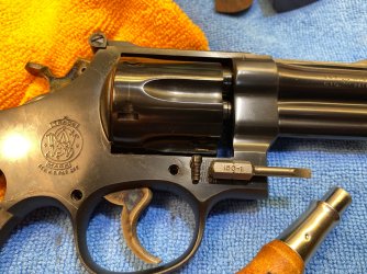

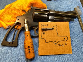

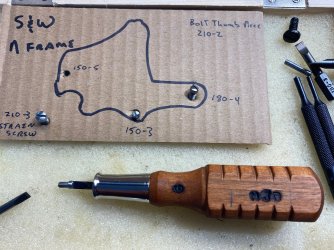

After cleaning out the slots with a toothpick, I use magna-visors and evaluate the best fit for the screw in front of me.
My experience is that the yoke screws have been 180-2/ 3 / 4. 150-3, and some 150-1.
Your 210 options seem too wide and will ream the margin of the counter sink in the side plate.

View attachment 765438View attachment 765439View attachment 765440View attachment 765441View attachment 765442
You Sir, are a Prince amoung men, that is what I was looking for, thank you!!
