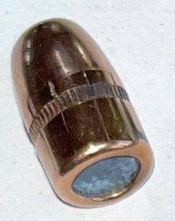

Friend and I were up at the range today. He had a box of PMC Bronze .38 Spec., 132 gn. FMJ and had 8 FTF. He was shooting his Model 10 no dash which has not exhibited any FTF problems with other ammo. Primer strikes look normal.
I brought the offending rounds home to pull them and check for powder, but 25+ whacks with my Frankford Arsenal kinetic bullet puller didn't even budge the bullets and I don't have a collet-type puller.

I still can't figure out why the bullets are seated so firmly that I can't whack 'em loose with my kinetic bullet puller! I found I do have a Forstner collet pullerr but it's for a smaller caliber so no joy there.

Put the offending rounds in a .38 Spl. seating die and set the bullets back a few thousands of an inch to break the seal. Then use your kinetic bullet puller to finish the job.
Hope this helps.
