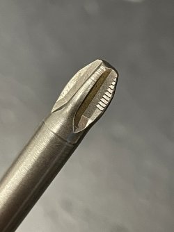

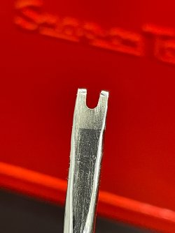

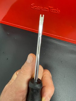

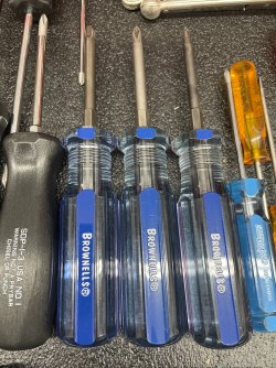

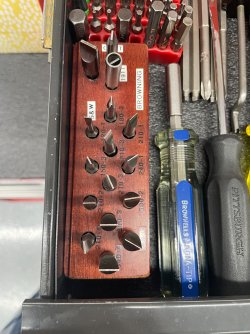

I am a HUGE Brownell's screwdriver fan! I have owned a set of them for 4 decades and they are all still in perfect condition and are as good as the day I bought them. Believe me - they do get used a lot! There was only one single exception - a bit which is an ultra thin and wide bit for a Browning A5 shotgun. I did happen to bend the ends of that particular tip trying to remove a stubborn, rusted in place screw from my friends A5 he had just bought. I did eventually remove the screw and Brownell's just sent me a brand new bit - no questions asked.
They are hardened to just the correct harness, expertly hollow ground and the handle choice to get (at least IMHO) is the magnetic "Law Enforcement" handle if you are getting that type. I also own a set of fixed blade Brownell's as well. Again, they are fantastic! IMHO, I believe the Brownell's brand is USA made by Apex tool which in my mind make the absolute best screwdriver blades made! They blow away every other brand I have ever tried - including Snap-on, Proto, Mac, Matco, Wera, and the highly touted Japanese brand, Vessel!
Brownells prices have crept up quite a bit over the last decade, however IMHO their screwdrivers are actually quite reasonably priced for what you get! Also - if you use Phillips screwdrivers, get their 3 set fixed blade/handle #1,#2,#3. they are incredible! They have small anti cam-out striations on the flutes which prevent the blade from walking out of the Phillips head. I=After owning a set for a few years, I bought 5 sets to give my friends as Christmas gifts a while ago - hey all love them including one of my auto mechanic friends.
BTW, the rest of the bits in the soft plastic bit holders are ALL Apex which I do believe makes them for Brownell's. The "junker" Pittsburgh brand screwdriver (I found in a parking lot) I used to make a rear sight nut removal tool as their screwdrivers aren't really good for much else - lol.
