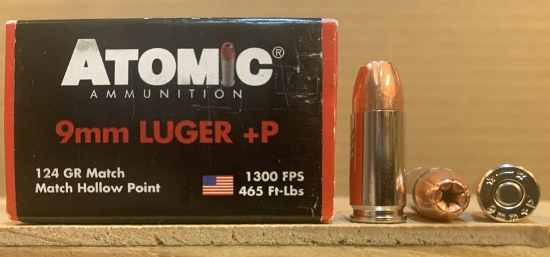

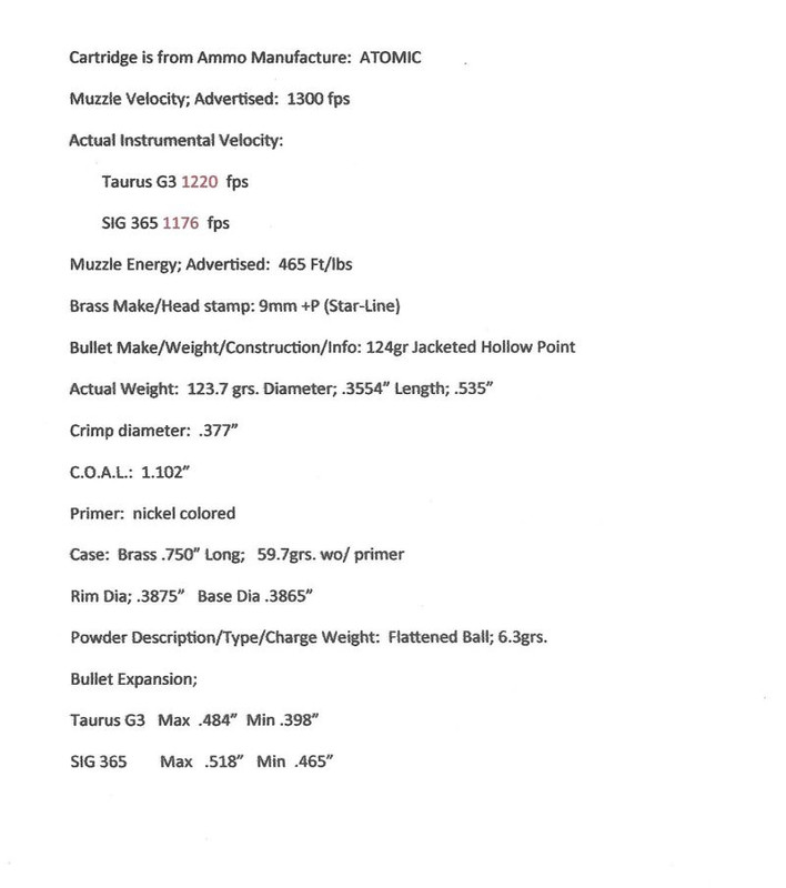

Most of the 9mm reviews that I did were shot with two guns.
A SIG 365 SAS, with a 3.1 inch barrel and a Taurus G3 with a 4 inch barrel.
First I do forensic exam of the ammunition. Next I shoot a group while chronographing with each gun. 10 yards with the SIG and 15 yards with the G3. Chronograph is a Oehler 35P
Then the ammunition is shot out of each gun into a 55 gallon plastic barrel of water. The bullets are then recovered, photographed and then measured for expansion. In cases where the bullet fragments and loses its jacket, a weight is taken with all the recovered material and also a weight taken with just the lead core.
Here is the link to all the photos of the review;
9mm Atomic 124gr JHP — Postimages
Data sheet;
Velocity is consistent with +P ammunition I've tested. Although impressive, the bullets didn't do well in water as they fragmented badly. Accuracy is pretty good with this ammunition. I do get flyers with the G3 once in a while.
