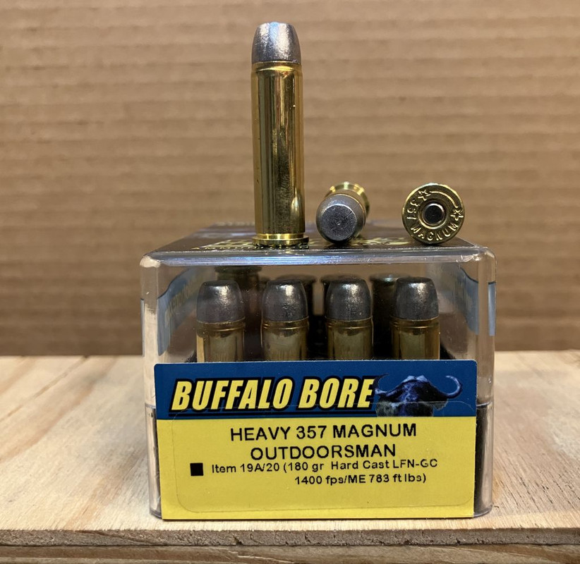

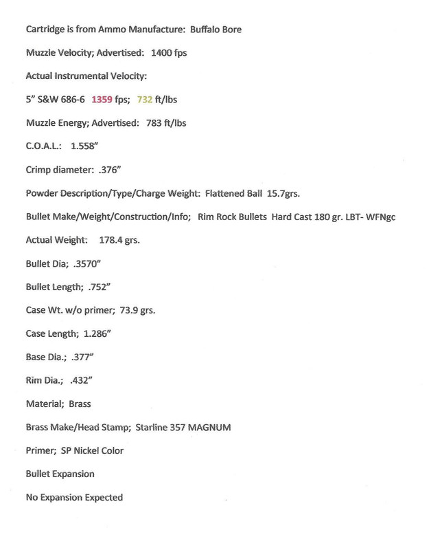

This ammunition was shot out of a 5 inch S&W 686-6 at 25 yards. The target circle is 4 inches.
Velocity data taken from an Oehler model 33 chronograph.
A forensic examination was done with the ammunition.
Here is the link to all the photos of the review;
357 MAG BUFF BORE 180gr CAST (2) — Postimages
Data Sheet

What is of particular interest with this ammunition, for me at least, is that it will match or slightly exceed the performance of any 180gr 10mm round out of a 4.6 inch or shorter barrel. Since the 180gr .357 bullet has more sectional density than the 10mm counterpart I would think it would penetrate even better.
Accuracy was Ok. Recoil was significant, as you might expect, but not as much as a full power .44 Mag. For woods carry, this round would be worth considering.
I've used that same LBT bullet design (without the gas check) for more than thirty years. Highest velocity with what I consider a maximum load with #2400 or 296/H110 powders has been about 1200 and 1250 respectively from a 6" barrel. That Buffalo Bore load is really moving...

Yes it is.. There was some discussion/speculation on another forum a while back that B.B. might be using something similar to CFE BLK powder. That powder is a step slower than the ones you mentioned, which might explain the rather heavy charge. I haven't seen anyone test this theory as yet.

It would be really interesting to see some pressure data on BB ammo.
Either they have found some magic blend of powder that lets them achieve higher velocity than other ammo makers or they are just loading it to higher pressure levels, possibly over the SAAMI limits.
I would like to believe its the former but the latter seems more likely.
Buffalo Bore has always taken great pride in delivering what they promise. If the pressure data came from their testing I would believe it. But they do sell ammo like anything labeled "heavy" or 380 +P that does not have a SAAMI spec and is loaded to higher pressure levels. If they sell ammo for 380s that exceed SAAMI standards they likely do so for other calibers.
