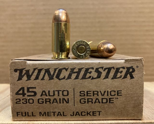

Hello

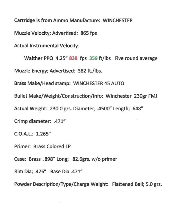

The 45 AUTO reviews that I did were shot with a Walther PPQ 45 with a polygonal 4*¼ inch barrel.
First I do forensic exam of the ammunition. Next I shoot a group while chronographing. Targets were were set at 15 yards. Chronograph is an Oehler 35P
Here is the link to all the photos of the review;
45acp WIN Ser Grd 230gr FMJ — Postimages
Data Sheet
I found this ammunition available from Fast Ammo out of Dallas Texas for $15.85 (31.7 cents per round), for a box of 50. With shipping, $28.00 delivered. Not bad. The ammunition is accurate enough and very consistent. Velocity is about where it should be. As a plus, I will now have 50 pieces of Winchester brass to play with.
I'd wager that and average of 838 fps from a 4 1/4" barrel will translate to 860-875 fps from a 5 inch barrel, so this sounds like real mil-spec service grade ammo, not the now common 230 grain FMJ stuff that barely makes 830 fps from a 5 inch barrel.
If memory serves the military spec was 825 FPS +/- 20 FPS from a 5 inch 1911.
