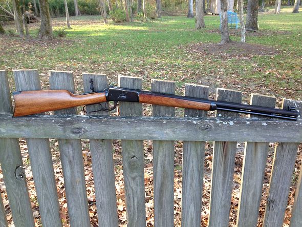

Mine have all made the trip to Port Arthur Texas to see Steve Young. Added about another $150 to the cost of each gun, but I consider it worth it.
