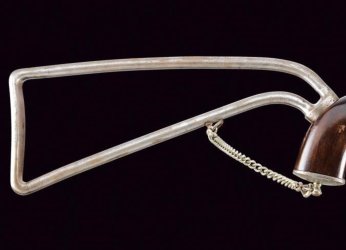

Here's are pictures of the back strap on the S&W showing the modification for a stock to be attached and the Lefauchuex back strap. The stock used for the Lefauchuex is also shown.

The slot design on the backstrap is an early one found also on early flintlock and cap & ball single shot pistols. This design was more often mated to a wood type extension stock.
The skeletal metallic stocks were more often universal or like Stevens or Frank Wesson were screw and slot mounted.
Photo 1 shows that type of male fitting on a wood stock. This is a very early type design.
I can’t really comment on the European wire stock except to say that legit period stocks were not welded. They were cast only.

Thank you! That's the first picture I've seen that shows the what the male fitting looks like. With your info I was able to find this example:
I wonder the odds of finding an original (or even a repro) stock with this type of fitting?

I honestly think it would be difficult to find the original stock for this Smith & Wesson revolver. IMO it was done by a Major Distributor in the 1870’s time frame. That’s a very difficult time to research. Very few Distributor catalogs out there from the 1870’s so that leaves you with honestly the best option IMO is a reproduction stock and fabrication of the male key to fit.
Lots to choose from out there. I just purchased a period skeleton stock that I will fit to my 10” S&W 38 SA.
Photo 1.
There are also wood blanks for sale out there. Then all you need is a fabricated male key.
