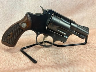

This one is #30434. It has the short frame, round trigger guard, flat latch, serrated ramp sight and trigger. Matching frame and cylinder, grips numbered to a different gun.
I am curious as to when this Baby Chiefs Special was made (month/year), SCSW 4th seems to indicate early 1953 (number made, 28916, starting at 21343?).
Are these correct mini-Magna stocks? (besides being mis-matched, they do fit the short frame)
Are there any differences in stocks between Baby Chiefs and Terriers of that period?
Does this have a 2nd type flat latch?
Is this the “fine knurled early hammer”?
Any/all information would be appreciated… I can provide more info/pics if needed.
I think it is probably best to wait for two-bit cowboy to comment with authority. However, I'm seeing 2" guns with serials near yours that shipped in April-June 1953 with 1st Style flat latch.
Thanks Wiregrassguy, that date would make sense by extrapolation. I would assume the Model 1953 (starting around 462XX from what I've researched) came out later in the year. So this one has a type 1 latch? Also curious about the grips (could they be Terriers) and hammer...
Thank you for sharing the complete serial number of your five-screw Chiefs Special. It helps build the database.
Based on one other in the database, serial number 30445, I'd estimate yours shipped in or around April 1953.
Yes, you are correct that yours has the second style flat thumbpiece (Guy didn't study my Chiefs Special thumbpiece display in Concord closely enough last month.)
And, yes, the Terrier stocks of that era interchange with the 5-screw Chiefs Special. If your different-numbered stocks came from a Chiefs Special, their serial number would be in the 1 - 46000 range. If your stocks number 60000 or around there, they are from a Terrier.
The "1953" name is one Smith & Wesson assigned to the .22/32 Kit Gun, and it does not apply to Chiefs Specials. The last known five-screw Chiefs Special with a 2" barrel is serial number 45963. It shipped on April 30, 1954. The first known ship date for a carbon steel four-screw Chiefs Special (long oval trigger guard and ⅛" longer grip frame) is June 4, 1954.
Smith & Wesson used the small hammer on Chiefs Specials from the first one in October 1950 through at least May 1956.
