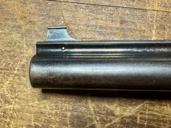

Another direction to investigate would be the target sights. I know very little
on the history of the target sights S&W offered for the NM#3 and at what
times they were available to the public.
I notice this one has the elevation screw in the bottom. I would like to see
more pics of the rear sight and maybe the more knowledgeable members
would comment on when the type was available.
Cheers!
Webb

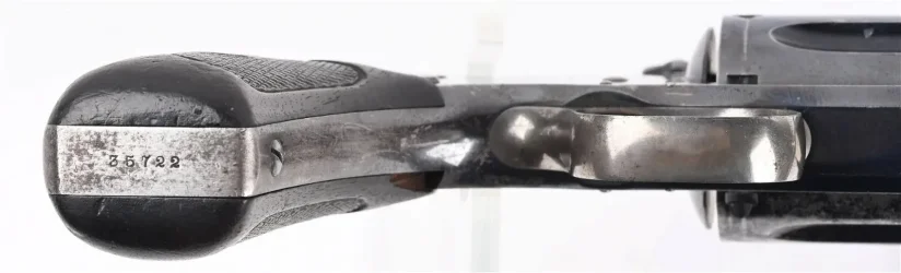

On a side note, have you lettered these revolvers? I believe 34352 was shipped on Sept 1, 1898 and 35722 may be part of the last shipment to Japan on Mar 11 or May 15, 1908
Regards, Lyle
Hi There,
I've located the letter for SN 35722.
I hope to turn-up the letter for 34352 soon. From what I remember,
it was part of the 1905 shipment to Takata & Co.
Cheers!
Webb

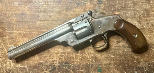

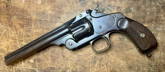

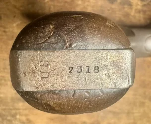

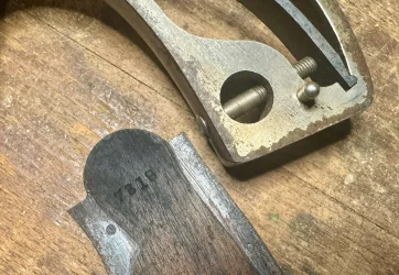

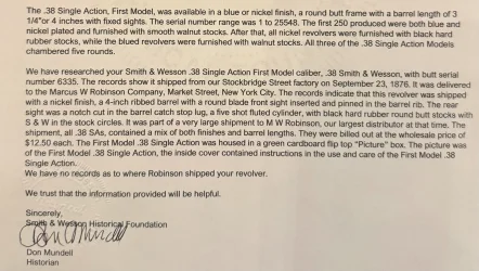

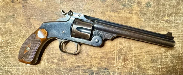

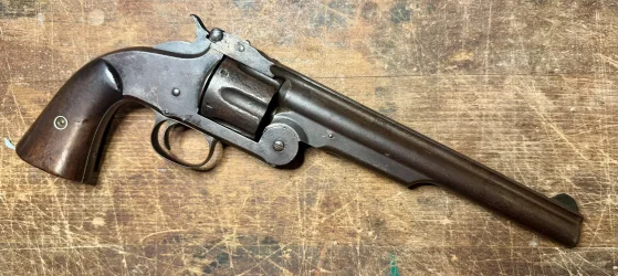

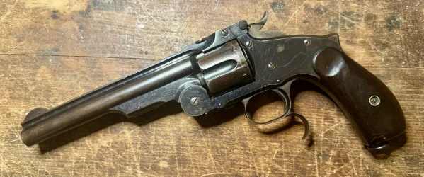

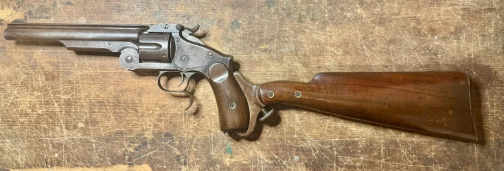

We explored S&W serial number fonts in a different thread but for fun, below are the S&W's I have with the with the round top number 3 or flat top number 3's (or both).

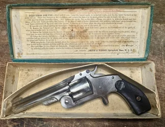

First up is a Baby Russian 6335, shipped Sept 23, 1876. This is the "newest" Baby Russian with the early 3 font, the later ones have the flat top 3.

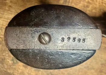

Next are some Model 3's. I have a 44 Rimfire American with a later serial number 32585 that has the round top 3.
Next is a Russian 2nd Model with mixed 3's, serial number 37156. The butt of the revolver has a flat top 3 with a round top 3 on the grips. The other components have an assembly number of 707 (no 3's)

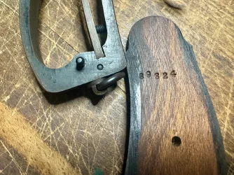

Next up is a Model 3, 3rd Model Russian, serial number 39324 with a flat top 3's on the butt, round top 3's on the grips, assembly number is 404 (no 3's).

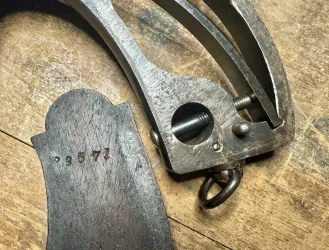

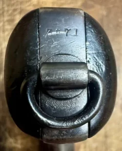

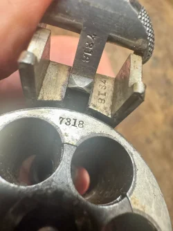

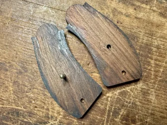

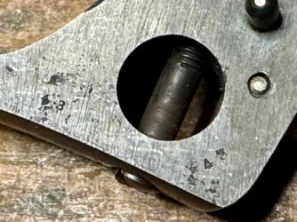

Now to New Model Number 3's. We have seen 43. Serial numbers 1633, 3571, 3858, and 7318 have flat top 3 serial numbers on the butt and round top serial numbers on the grips, cylinder, latch, and barrel. 17163 has flat top 3's on the butt, barrel, latch, cylinder, and a round top 3 on the grips.

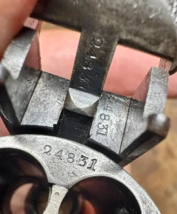

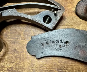

Serial number 24831 is the lowest serial number New Model 3 that I have that has the flat top 3 on all components - Butt, cylinder, Latch, Barrel, and Grips.
Hi There,
So far, your examples of round top "3" were all made before 1878 and hence
were made before the NM#3 came out. I think it is best to use only NM#3's
for this comparison.
It is my understanding S&W machined out the frames, fitted the grips and
serial numbered them first. These 'completed' frames were put into stock
and sat there until a work order is generated and the frame is then pulled
from stock by the 'fitter.' Based on the work order, the fitter would pull the
needed parts and fit the gun parts together. The cylinder, barrel, frame and
barrel latch were then given their respective 'fitting number' (which by the
the time the NM#3 was in production was the serial number).
So, does anyone else have a NM#3 that has this mixture of 'round top' and
'flat top' number "3"s?
Cheers!
Webb

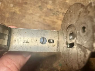

Hi There,
Is that one of the Henry Nettleton inspected NM#3's? I didn't notice his
initials. Still a very nice addition to any collection.
But this shows that both kinds of "3"s were used; at least during that time.
And it may be an indication of the time frame when SN 43 went back for
a barrel change and target sights. But more examples should be obtained
to determine any pattern.
Cheers!
Webb

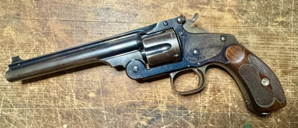

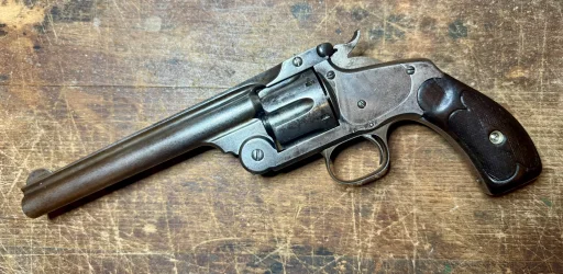

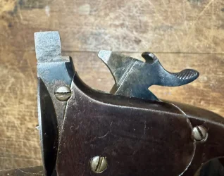

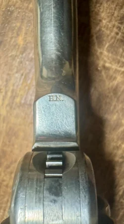

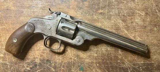

Webb, yes, it is a Nettleton example.
IMG_8286.webpIMG_8287.webpIMG_8288.webpIMG_8289.webpIMG_8291.webpIMG_8292.webpIMG_8293.webp

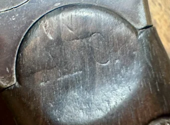

Hi There,
Fantastic!! The recoil shield shows virtually no wear. That indicates it should
be in good mechanical condition. Does the cylinder and grips show any
evidence of Henry's initials? How about the DAL cartouche on the grips?
Getting back to the mixed style number "3"s, The 'Bible' says that these were
made in 1878 and hence were first year manufacture. The 280 revolvers were
number in the SN 7127 to SN 7405 range. This example shows round top
"3"s on all fitted parts as well as the grips. The serial number on the butt is
the only place a flat top "3" was used. So, a round top "3" was in use by the
'fitters' (at least one of them) to stamp the parts when fitted to this example.
Now, it would be nice to see more early examples!
Cheers!
Webb
