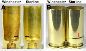

I've never encountered one of the 9X23 Win. Colts at a LGS or gun show. I'd probably have bought that one too. The 9X23 Largo is definitely not the same as 9X23 Winchester. I had some factory 9X23 Win. ammo, both Silvertip and JSP, and brass, and used to reload it. The 9X23 Win. case is hell for strong, and was of course designed to be used in the traditional non-ramped barrels that Colt still uses, without blowing case heads. I lost interest in loading it when I found that in the well supported, integrally ramped, barrels other manufacturers use, .38 Super/ Super Comp and .38TJ brass can easily be loaded to 9X23 Win. velocities if desired. The .38S type cases have more case capacity than 9X23 Win. cases, and I don't believe 55000 Lbs./Sq. In. pressures are required to achieve 9X23 Win. ballistics. At least I've never encountered anything like unusually bulged brass, blown case, or even a pierced primer in loading to 9X23 Win. ballistics. I've adjusted both 9X19 and .38 Super dies, and loaded 9X23 Win.. Yes, I know that perhaps that shouldn't work, but it did for me with nothing remarkable to report about the process at all.

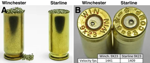

Brad Miller's old .38 Super.net site has a World of good info on loading the .38 Super and 9X23 Win. series of cartridges. He indicates that even the Starline 9X23 Comp brass is not quite as robust as the original 9X23 Win. brass. I attached some of his photos showing the relative case wall thickness and difference in case capacity between Win. 9X23 brass and the Starline 9X23 Comp brass.
winchester_vs_starline 9X23 powder capacity.webpwinchester_vs_starline 9X23W_brass - Copy.webp
