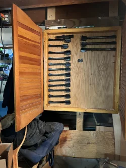

I picked up my first Contender G2 a few weeks ago. It has a 6mm Bullberry barrel, case hardened receiver, Burris 3-12x32 scope, and custom wood. Looks like it's hardly been shot.
I also picked up a 10 inch 357 Magnum octagonal barrel and new forend. I bought a matching grip, but it's for an original Contender and doesn't fit a G2. Now, I know!
    1.4 MB
    1.5 MB

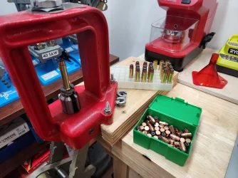

Well, I decided to head back to reloading, and decided I would do so with the 22 hornet in a Thompson contender format so I placed a WTB ad on the forum. I got a response from a 2 month member for a hornet pistol. Long story short, I got scammed for 500.00. Charges to be filed with USPS for mail fraud.
Now being in RI and a non resident the only thing I can buy is a rifle. LGS owner had a TC carbine tucked away in 22 magnum. Like new, bought that. Also a 10" 22LR barrel. Got to keep the ammo cost dawn. Then I still do not have a hornet barrel. Bought as new barrel with forend scope base and rings. But wait, I need a pistol grip, bought that but I also needed a 10" round wood front grip. Bought that too. Bought assortment of screws for mounting front grips
UPS just showed up with powder, primers, shell holder, neck dies, primer tray, funnel, heads, and other assorted accouchements. I had already bought Lyman Hornet full size dies.
Now I still need a scope ,base and rings. One set or 2X setups?? Probably need a new manual.
I do have a scale from way back and a Lyman Spartan press that a great forum member gave to me for the cost of shipping with primer feed.

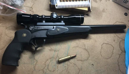

I've had this G 1 for several years with a 223 and a 44 barrel for it but just couldn't get it to act right for me. I got a notion to look for a match grade 22lr barrel to see how it would do out to 100 yds in small bore IHMSA competition. I haven't hit 40/40 yet but I'm almost there. I finally found the bottom of my rabbit hole. BTW, built for speed, not for looks.

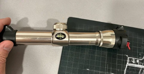

Is that a rifle or a pistol scope?

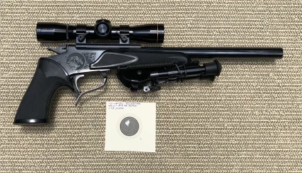

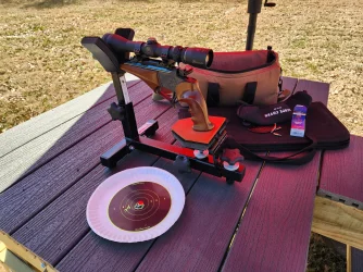

Some fun with mine with the .22 match barrel. Have a nice collection of 10" bull barrels, .22, 22 wmr, 357, 357 max, 44 mag, 41, mag, 45 acp, 45 colt, .222, and .223. Still looking for a 10" 38 super and 9mm bull.
Just started load development for the .357 max, that should wake me up.
This was sighting in the new scope at 25y, cci sv.

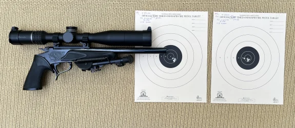

The 14” .22LR MATCH barrel does have excellent potential:
(Five rounds LAPUA Midas+ on 6” steel at 200 yards from .22LR Contender, with Burris Veracity 2-10x42 @ 24 MOA elevation above 50 yard zero.)
