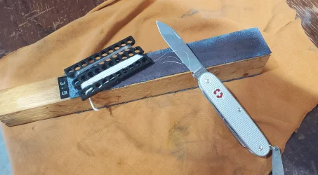

It worked great, but we'll see how long it lasts. I started the stropping with red Rouge then went to the 3.5μ and got it whittling 15# test fishing line with little effort.
3.5 micron will work well - close enough. I've never heard of that brand but there are probably many I have not heard of yet. Let me know how it works and how the longevity is please.
