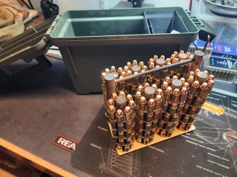

Those cartridges work because they have Federal primers which are the softest. I have a 327 WR 9mm competition only DA only revolver with a lighter trigger return spring, extended firing pin, and 3/4 turn off factory main spring yielding a 6lb sweet trigger. I load my own ammo using Federal #100 primers only. Goes bang every time. It will not fire with CCI or Ginex or other primers, just makes a small dent lol even with the extended firing pin. So just use Federal or load your own with Feds.
And I shoot this gun at least 700 rounds per month (steel challenge only) loaded to 500fps too.
