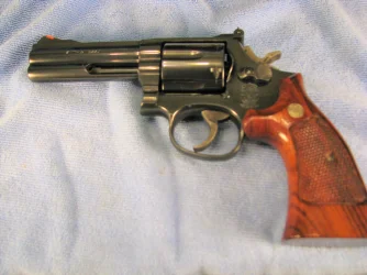

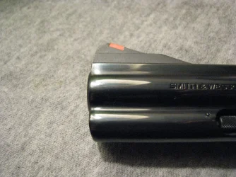

586 no dash
Very nice! And I love those grips! I too have a no-dash 586, which is a favorite handgun, but mine did go through the recall, so no issues there. Also, mine has been restocked with a set of nice Altamonts. Gotta love the old 586s!
Between the 586 and a no dash 4" 686 they are my main woods carry lately.
I switch to rubber Hogue's to shoot and carry.
I dare say about the only way to make a 4" 586 more perfect would be to pin the barrel and recess the chambers like the older K and N frames and add a 7 shot cylinder. Never happening, I know, but that would be simply amazing!
Tom

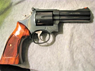

Have a 586 no dash with M. Picked it up a little over 4 years ago at a gun show. Came with original box , pamphlets and instruction manuals. Serial starts with AJY. Spec order date on label is 6066, March 7 1986. Dealer said when he got it , it had Pacs on it so he put on some nice target stocks as the the label said TS. When I got it home I removed the stocks and found they were date stamped Feb 11 1986 less than a month before the gun was made. Has no barrel end wear and very light turn line.IMG_4631 (1).webpIMG_4644.webpIMG_4632.webpIMG_4635.webp

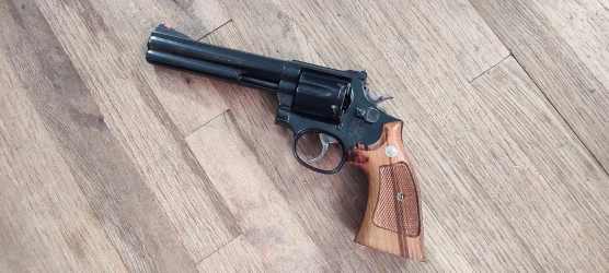

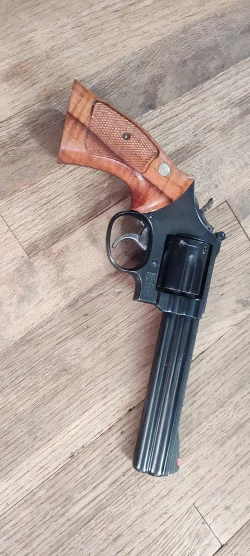

Love mine as it has no M stamp and 6”.
