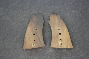

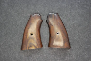

Here is a set of N frame grips that have screw holes on the back, presumably to hold the stocks. Possibly these grips have been sanded down and were once checkered? The screw that came with them is not long enough to have been original, but is 6X32. There is no escutcheon on the screw entry side. They fit my pre-war HD, however one panel does not go all the way up into the frame circle. Has any one seen similar "jig" marks?_MG_7019.webp_MG_7020.webp_MG_7021.webp_MG_7024.webp
Likely home made replacements I would suspect. I bought an M&P a while back that had a set of homemade grips, very plain and similar to these. They did have a factory screw but it was threaded into the wood without a thread escutcheon.
Those are not S&W factory stocks, probably home made, so the odd stock screw thread, no escutcheon, no medallions, etc. mean nothing. One big clue on any stocks is the screw. S&W factory stocks (made in the "stock job" are all 5x44 NEF. Any stocks with a 6x32 NF thread are after-market or home made.
Yea, I knew they weren't factory. The use of screws to hold the wood along with the other holes are caused the wood to start cracking, probably from overtightening.

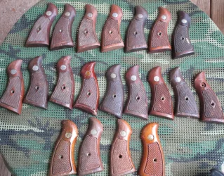

I’ve never understood why a talented woodworker that can craft such beautiful grips (and then not be able to install a professional looking escutcheon set).
There are so many junker factory grips laying around and so easy to harvest a nice set.

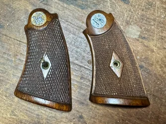

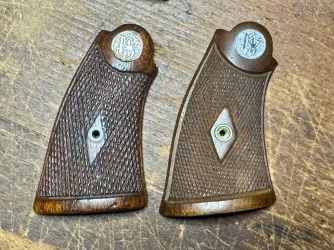

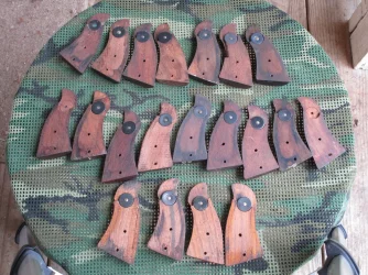

I bought a box of old LE K frame grips years ago. Friends have made use of escutcheons and medallions. There were a couple sets that were salvageable that I used.

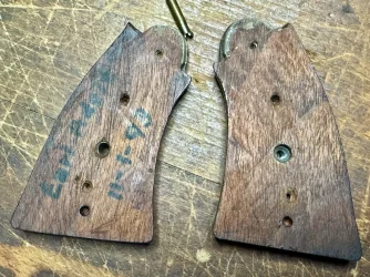

I think this set was sanded down, as the grip nut seems to shows it. I took it out and it was designed for such a purpose but the enlarged exposed portion had been shortened. The lack of entry escutcheon was a Colt thing, maybe that was the influence. Sure doesn't protect the wood from the screw driver.
I have set of pre-war grips I purchased that were on a Victory model along with an Outdoorsman that they fit on. The grips are a pair with similar jig marks on the back that were made to look like pre-war trips. I have pictures of them next to factory grips for comparison.
