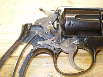

Interesting 38 Model 1905, 1st Change revolver with a nice finish, but refinished as you note and Magna stocks added much later. Originals would have walnut concave top-round walnut service stocks or hard rubber stocks. There is no S&W logo left on the sideplate. That did not happen until 1917 with the advent of WWI and your revolver most likely left the factory in 1906.
Let me add that this model was when the rebound slide was introduces,, but yours appears to have a flat trigger return spring like below.
The 1905 I have has the rebound slide.
