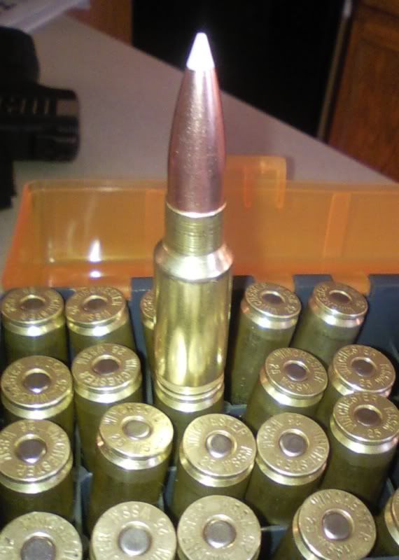

All kidding aside, I wanted to post my first results with the .358 WSSM. Just got the Encore receiver and put the thing together. Cheap scope, 4-16X Barska (had a coupon for $30 off from MC Sporting Goods). The barrel is a "standard" wildcat from MGM and purchased through Just Hunt (I have no affiliation with them either) here in Indiana. Great folks.
Brass is OUT OF THIS WORLD for price! $100/50! It starts out with a 25 WSSM and is necked up to accept the .358" bullet. That being said, I can see me running some cast bullets out of this rifle just to bag a squirrel or two! :)
The load is based around a Nosler Accubond 225gr BT originally designed for the 35 Whelen.
I can hear you asking "WHY?" Well, we have some pretty flat land here in Indiana and high powered rifles are not allowed for deer hunting. Several years ago, they came out with a regulation that allowed for "pistol caliber carbines" and they have expanded it a bit. Minimum case length: 1.16", that does away with a bunch of under power auto and revolver rounds. Maximum case length: 1.625", that keeps someone from using a .30/06 or something like it. Minimum bullet diameter: .358"! So, there you have it. That is the answer to your "WHY?" Some smart cookie took all of that and came up with a round that would fit all of the criteria, and what a round they came up with!
Take a look:

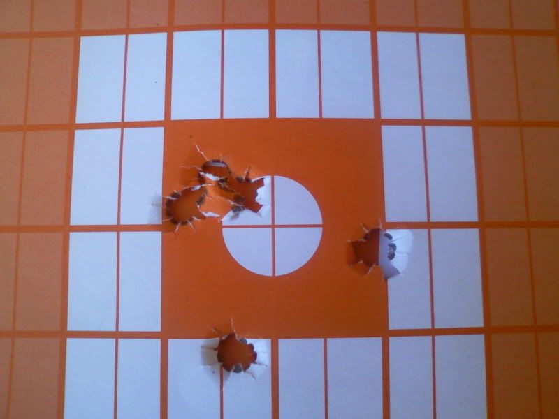

After shooting 22 shots, and having to clean the barrel after each of the first 5 shots and again after each group of 5, I was pretty well done when I got done! ;)
The 225gr bullet is supposed to be traveling at 2500fps or so. I forgot to take the chronograph to the range today though! Next report though!
Here is the smallest group I got at 100 yards though:
(3 shots at the left were after a scope adjustment to get them to that point)
