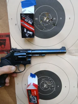

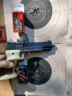

I couldn't remember the preferred ammo for my Pistolas so shot a test Friday 25yds.
Anyone having any luck with CCI Standard Velocity?
