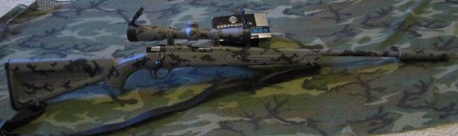

My AAC Scarab cannot be disassembled, but I do have a Branson 2210 (heated) ultrasonic tank. I use Carbon-X and you can see the cloud of carbon residue floating out until it is perfectly clean. Also, I only shoot RWS sub-sonic, as it is very clean and a very consistent velocity. Carbon-X is water soluble and rinses clean. I avoid first round pop in The Scarab by not shaking all the water out, or, if it's already dry, a quick squirt of Rem Oil. It's very quiet on my MkII. I just hold my thumb on the bolt to avoid bolt slap. On the 77/22 it's super quiet.
