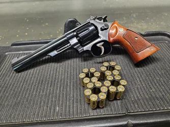

I am a relatively new owner to this gun and have only put 1400 rounds on it. An untold round count by the previous owner. And use Ranch products moonclips. Picture below shown with xtreme 200gr 452"s.
I should do accuracy tests with this gun with properly sized bullets for it. But I don't shoot it very often. Someday I'll make the time.
