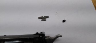

Hold the presses! I forgot I have a Heavy Frame Target .22 and M&P 1905 Target with the same rear sight blade set-ups!
I tried swapping those flat blades--success!
So what I need is pictured below.
Anyone have/want to sell one?

Lacking one to buy, they're child's play to make! OnlineMetals.com has the stock (.040") as I recall--------and at least didn't have a minimum order---back when. Annealed 4130 steel is what you're after----easy to work with. A piece about the size of a stick of gum works fine---because you need something to hold onto. Stick it in your vise, and start whittling.
Ralph Tremaine
A couple comments. The rear sight blade shown is from 1913 or later with the wedge base. Earlier blades, according to Bob Neal's research were square base and likely the reason why many that have gone missing. Noting the drawings below, the U notch shows as narrower than the earlier ones, but not sure which frame size Bob was using as the examples.
I have one of the post-1913 HFTs with the wedge base and the slot measures .050" U shape. It is suggested by Bob that rear sight blades were all square base before that year.
If one looks closely to the images in Bob's work, you will notice that the screws of the square cut base are flat-end and the screws of the wedge shaped sight base use beveled-end screws like the one in my picture. To know which sight blade is correct, just check the screw end shape.

My 3rd model rear sight assembly does indeed have beveled-end screws.
I was surprised the smallest 4130 annealed steel flat .040" sheet offered by OnlineMetals is a 12" square that costs $28.89 plus $9.21 shipping!!
I may wait few days to see if anyone has an extra blade for sale.
My front sight reads “Marbles//35A”. The anchor hole is torn open at the bottom and it was loosely pinned with a piece of copper wire. I did get it securely mounted with a proper blued steel pin.
That Marbles sight would call for a "U" notch at the rear.
And speaking of waiting a few days to see about an extra blade, the "want ad" you've posted in this section is all well and good, but an ad posted in our classified section of the forum will be A LOT better as the classifieds have a VASTLY larger audience. (!!)
As an aside, don't be surprised if an original blade will go for about double the cost of the piece of sheet metal you mentioned.

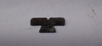

"U"-notch, flat, wedge-bottom rear sight blade
Ralph--before I post my very 1st "WTB" ad, please advise if the info below is correct. And may I please use your pic?
Colleagues
I have a Single Shot 3rd Model of 1891 rear sight assembly--missing the blade.
This blade was also found on other early target-model revolvers like the M&P 1905 Target and Heavy Frame Target models.
The blade should look like the pic attached--"U" notch, flat, wedge-bottom. White outline gladly accepted!

There's an old saying about "The KISS formula"------"Keep it Simple Stupid".
How 'bout something along these lines;
WTB----flat sight blade with U notch for small frame gun---3rd Model Single Shot. (Tell them the width of the carrier (Fits in a carrier of ?? width.)-------the blade for a large frame gun is .620" wide, and fits in a carrier of approximately that width---perhaps a bit wider---your carrier is smaller.)
And show them a picture----never mind your picture shows a square notch.
Now----my knee-jerk reaction is you're going to be hard pressed to come up with a U notch blade, because only the earliest 3rd Models have that----the later models (the VAST majority) use a Patridge front---with a square notch rear. That said, you could care less what sort of gun the blade may have come from, and the very great odds are your audience doesn't know what sort of gun their blade came from in the first place----other than small or large. The good news is there may be U notch blades from other types of small frame guns that I don't know the first thing about.
You could also care less about the height of a blade. If it's too tall, you can file it down. If it's too short, you can elevate your carrier. I'm pretty sure ALL the flat blades are .040" thick---------or whatever yours measures.
The End-----at least for now. If you want me to see a revised ad sample, go for it.
And yes, you can use my picture----never mind I don't have the first clue what picture you're talking about.
Ralph Tremaine

Revised proof for your scrutiny...
WTB--Flat sight blade w/"U"-notch for small frame gun
Colleagues
For a Single Shot 3rd Model of 1891.
Carrier width--.620"
Thickness--.040"
If you have a semi-circle or square notch that meets the other specs, please advise.
Thanks in advance
Bruce
