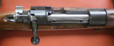

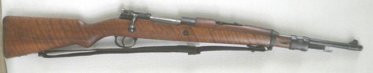

The Belgian-made Morrocan 30-06 carbines have a clearance cut in the front receiver ring for the 30-06 bullets to clear when cartridges are being stripped into the magazine. There is a 30 stamped in the rear receiver bridge but it doesn't show up well in the photo.
