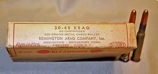

I was rifling around in my safe and found a 30/40 Krag full-size military rifle. I remember buying it a long time ago; original sale tags still attached. I searched for ammo in the cabinet and found none!
I would like any ideas you all may have on where to source ammo. Local stores just go "DUH"'

You may be able to find some ammunition but it won’t be cheap. If you reload, .303 British cases can be used if you can locate any. Also, .30-40 brass may be more easily found than loaded ammunition. Older ammunition sizes no longer used much are just not widely distributed these days.
I looked at Ammoseek prices above. Wow. Just WOW. You should take up reloading.
I did take a quick stroll through Google, and it seems there are many sellers of unprimed .30-40 brass at prices around 50 cents to $1.00 each.
The 30-40 is a great rifle for fun at the range, but as stated the price of ammo is very high.
I think finding brass, bullets and a die would be best if you plan to shot that rifle a lot.
The 180 or 220 gr. RN bullet is the standard factory load, that feed without any problems, in that rifle.

Original military rounds were 220 FMJ that ran around 2000fps. That is the ammunition your the gun is sighted for. I once bought a box of 180g and could not get the rear sight down far enough to shoot at 100 yards, so always shot high wit lighter bullets.
You will find most all vintage ammunition was loaded with 220 grains, some FMJ and some soft-point. Had to show an unusual cartridge I found when buying a box of odds & ends 30/40 rounds. Appears a little too long to chamber, so never shot it.:)

I bought him HSM ammo years ago. I just checked their website and they have Sierra Game King and Cowboy loads.
You searched for .30-40 Krag - Hunting Shack Ammunition
I keep my eyes open at gun shows for 30-40 ammo. There’s usually someone selling remanufacered ammo that has a box or two.
What I’m actually looking for is surplus 220 gr. military ammo. I usually come up with a box or two.

30-40 has been relegated to the 'Load it once in a while' list by the ammo makers.
I see it at Gunshows quite often, but like all factory ammo, it isn't inexpensive.
Reloading it is easy. It's a great round to load and brass last a long time.
