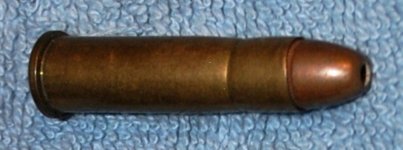

Here is a picture of a Rifle Only .32-20 round, courtesy of alk3844. It is loaded with a 80 grain jacketed hollow point bullet. The head stamp should read ".32-20 HV" for High Velocity. It is my understanding that this ammo hasn't been commercially loaded since the 1960s.

Someone always brings up the subject of not using the old .32-20 rifle ammunition in a revolver, making it sound like it is still available and sold. Indeed, it has not been made, at least by the big boys, for over 50 years (I believe it was last cataloged sometime in the mid-1960s), and probably 99% of any of it still remaining is found only on the ammo collector market. Not to say that a box of it couldn't show up at a garage sale. All "new" .32-20 ammunition made today (assuming you are fortunate enough to find some) is safe to use in a revolver. More recent Remington .32-20 ammo I have seen says "Rifle" on the box, but that is just to indicate that it can be used in a rifle, but not only in a rifle. It's confusing. It is not really dangerous (in the sense of presenting a hazard to the shooter) to fire old .32-20 HV rifle ammunition in a revolver, but there have apparently been instances in which the barrel in the forcing cone area has split as the result of using it. I have personally never seen a .32-20 revolver damaged that way. BTW, back early in the 20th Century, the factories also made HV rifle-only loadings in .38-40 and .44-40. They are fairly rare today.
