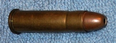

The RIFLE ONLY round has an 80 grain hollow point bullet and the headstamp has HV on it (for High Velocity).
Picture courtesy of alk8944.
