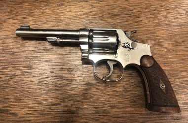

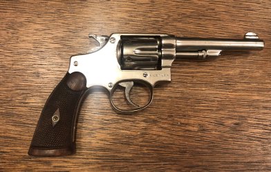

I have a 38 S&W marked Regulation Police # 4270, and a 32 S&W that looks exactly the same # 287580. The 32 is not marked Regulation Police. Is the 32 still considered a Regulation Police? I think the 38 was made 1917, the 32 probably much later.
When did they start heat treating the cylinders on these I think my 38 was 1917 from the low number, the 32 much later in the high 200 thousands.
Both have the extended wood grips with gold medallions. Neither have a trademark stamp on the frame.
S&W suspended stamping the trademark for WWI and didn't resume until 1920.

I personally won’t devalue a factory refinished gun. However beware. Just because the gun is stamped with factory refinish codes and the date, verify by examining it that it hasn’t been non-factory refinished after it was factory refinished.
Refinish date is Jan 1960. I think it had an easy life, it would rate 98% if you ignored the refinish point. It's a quality refinish, lettering sharp, no gouges , scratches etc. Looks original. I think I'll keep it, it's pretty if nothing else.
