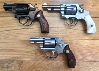

Look for a S&W 631 chambered in .32 H&R Magnum.
Honestly though I have fired more .32 S&W Longs through mine that .32Mags.
S&W 631 at bottom.
Top left is Charter Arms Undercoverette .32S&WL
Top right is S&W 32HE

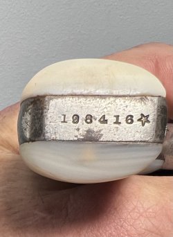

Mine is 198416 which I believe puts it around 1914.
